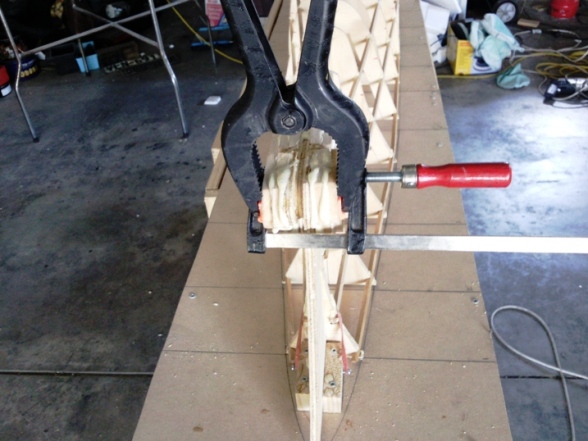

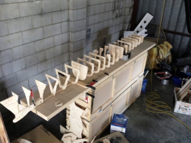

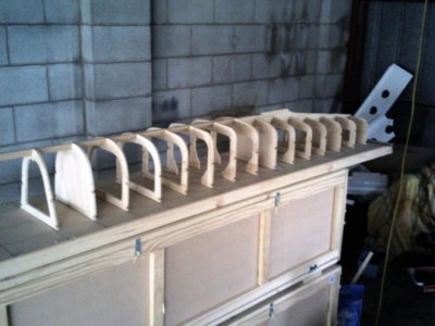

G'day all,
Here R some pic's of the start of my scratch build of USS California CGN-36 in 1/72 scale.
She will be 2.52m (Length)X 0.258m (Beam) X 0.138m (Draft) and will weigh in at about 28 to 30kg when finished. She will have a couple of 700 sized motor's driving a pair of 70mm 5 blade props from George at GT Sitek and Electronize FR15 ESC's.
Started her about 3 months ago and only just got stuck into construction!
(Construction has halted briefly due 2 excessive water logging of shed electric's due 2 overflowing gutter's!! It be a few days before I can do any more gluing on Cali... )
Cheers Bruce

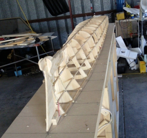

PostPosted: Mon Jan 10, 2011 7:43 am
Posts: 770
Location: Adelaide,SouthOZ

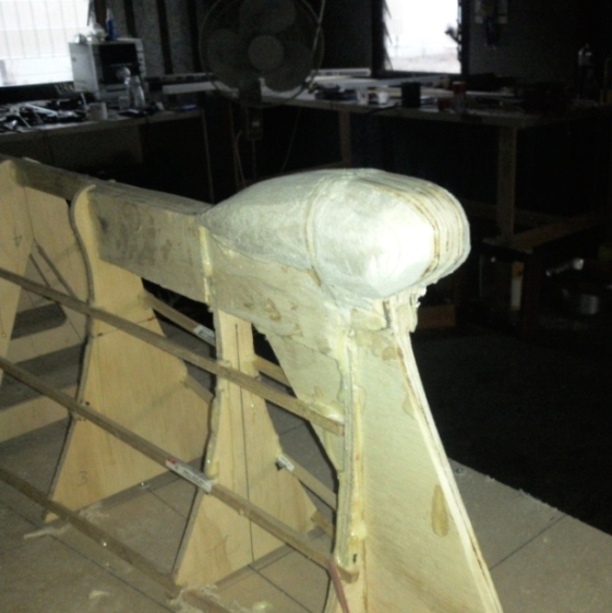

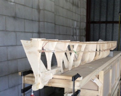

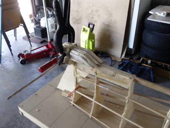

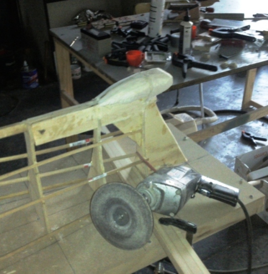

Mike you definitly want 2 do a California She is a great looking ship, R you thinking of an RC or static model??
I finally got some work done on my hull over the weekend and today!! Got the last (bottom) row of stringers on , I had forgot 2 do the slots for em when I was cutting out the rest!!! And have formed up the sonar dome using balsa blocks. Then I abused it with my trusty sanding disk on the end of my old drill. Now just have 2 give all the frames a bit of a tidy up with the sanding block before I do hull sheeting / planking.
Bruce :cool_1: :cool_1:

PostPosted: Mon Jan 10, 2011 3:11 pm
Posts: 652
G'day Bruce,
Cali is looking really good, especially like the balsa sonar dome....... :big_grin:
Probably a bit rich, advice coming from a rank amateur like me, but if I were you I would also "block up" forward of at lest your last frame and pre shape the bow before you begin your planking process.
I think Varyag's bow would have been much easier to build had I done that.
BTW it is STILL raining here in Brisbane, glad it is not snow though :thumbs_up_1:
Question, how do you work out where the stringers go and therefore where to cut the slots in the frames BEFORE you install the frames? Again, my Varyag was not too successful in that department and I had to "fix" a few mistakes
Andrew
:wave_1: :wave_1:
PostPosted: Mon Jan 10, 2011 5:58 pm
Posts: 770
Thx Dave, Its been slow going on Cali with most of my free time over the last couple of months being spent detailing USS Long Beach, LB can wait for more work for a while the weather is good for building!! Hopefully get a lot of work done on California's hull during the next few weeks.
I'm also getting stuck into the rebuild of an APS models ANZAC FFH for a club mate when the glue is drying on Cali.
G'day Andrew, There R a few ways of marking out the stringers 1/ test fit frames 2 keel then run a string line along hull where you'd like the stringer 2 go ( I used the actual stringer for the last pair that I had forgotten, cable tied em on then marked positions on frames) or 2/ stack the frames up with widest at bottom (Bow 2 midship & Midship 2 stern) then mark slot positions top one generally follows the deck lines, mid stinger I start it at the aft approx. waterline dipping down towards mids then curving back up 2ward bow, bottom stringer I have starting at the stern corners following the bilge line then curving back up at bow.
I will be using some blocks in the bow section I wanted 2 get the sonar dome shaped beforehand.
Cheers Bruce :smallsmile: :smallsmile:
