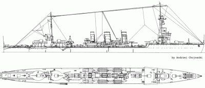

DavidP wrote:
why is there grooves on the bow & stern when not on the real ship? https://ww2db.com/image.php?image_id=2208
https://en.wikipedia.org/wiki/Japanese_ ... n_1936.jpg
the area where the keel joins the bow does not look right as in is it supposed to be stepped?
can you post a full side profile of the model as appears the main gun mounts are spaced apart wrong. https://upload.wikimedia.org/wikipedia/ ... n_1930.jpg
Hi David, thanks for your ideas!
The grooves can be seen from some angles in the historical photos (attached). They should be the grooves between hull metal plates.
We will check the keel/bow part from more literature search.
We typically don't post renderings from side/top/head-on etc. angles as experienced 3D software guys can use tools to easily generate the 3D models based on ours. Sorry and hope you understand.

DavidP wrote:
can you overlay the bottom link over the rendering's profile to see if the rendering matches the profile photo? at 1/350 scale, you will not see the grooves.
Hi David,
Our designer just confirmed that the bridge and smokestacks need to be slightly reduced in size, which could be the reason to make you feel the spacing between the 14cm guns is not right. The modification will be adopted in all the copies going to our buyers.
Thanks a lot, for your sharp eyes!

Nice effort, but I have some observations. Feel free to correct me.
The portholes appear to be way oversized and searchlights seem to be too small when compared with photos.
Did this ship have three propellers? Standard practice had the top of the rotation going outboard on opposite sides. I don't know about the middle one, but Titanic had three propellers and might serve as an example. It looks like all of yours turn CCW.
I seriously doubt that there were grooves in the hull. Welding would leave beads, unless they were ground off. Riveted plates would overlap.
I don't know if it's an illusion, but it would also be nice if the gun breaches lined up with the barrels.
Door hinges are usually on the forward side of the frame so they don't act as scoops if water comes over the side. I'm surprised that there doesn't seem to be any deck hatches, but I know reliable information is sketchy for this class.
Have you considered adding strips of etch with pulleys attached for the lower yardarms?
Are the funnel caps separate? It would be a whole lot easier to paint inside the funnels if they were.
Should the boats have oars? Aftermarket sets for other 1/350 Japanese ships usually include them.
Thank you for your patience regarding my comments. I like your choices.

Thanks Mike, all these are very nice and helpful suggestions for us to finalize the "mass-produced" copies before shipping them to the buyers. Our designer is taking a close look at your suggestions.

Another photo showing that they're not "grooves", but rather overlapping plates:
https://upload.wikimedia.org/wikipedia/ ... a_1925.jpg
You can see how the top of the middle plate is lighter, indicating it's reflect sunlight so it's actually on top of the plate above it. Meanwhile, the bottom of the middle plate is darker, indicating shadowing caused by the fact that plate is above the one below.
Then in the image you posted, you can see that shadowing caused by overlapping on the bottom of the top-most plate that attaches to the main deck.

I found these in my files. If you intend to portray the ship at time of loss, many of the portholes apparently need to be filled. Searchlight size is more in line with your renderings. You can compare them to photos to verify rigging. After some thought, is it possible the the "grooves" you are seeing are the degaussing cables?
