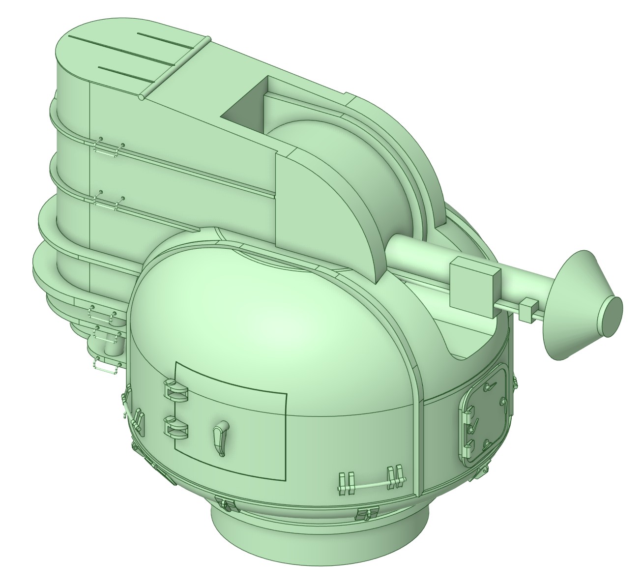

Progress -
PostPosted: Sun Jul 27, 2025 4:31 pm
Posts: 3119
Location: Mocksville, NC
Pretty much I think I've captured the major details and some of the minor ones on this launcher unit -
The main issue is scaling. For this I referred to the 5"/38 single gun mount base ring of 120" dia. The RUR-4 Weapon Alpha replaced the 5"/38 gun mount #52 and in doing so had to fit within the paratmeters of the existing deckhouse on the 01 Level of the ship. Without any dimensioned drawings, I think what I've come up with will work.
I've still got a few other details to add and it will be ready for a test print (@ 1/200 scale).

a new screen shot of the launcher with the CORRECTLY placed side access door hinges (which apparently no one caught!!) -
Work continues...
