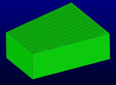

There are two methods of planking I use. One is relief planking, where the planked surface has to be flush with the surrounding surfaces, such as they are on subs. The second is the "proud" planking where the planking is laid on top of adeck surface as they are on a battleship.
First, the "relief method:
The goal of this demo is to etch planking onto this fictional chambered deck.
First I do a 2D pattern of the deck planking with surrounding boarder, making sure that all areas to be "reliefed" are closed.
Then I use a "extrude closed profile" to use the outline to make a solid that will pass through the deck in question
Here it is relative to my deck.
Then I trim this solid to the deck leaving the bottom edge conformed to the deck shape
Then I have an "un-stitch" function that allows me to seperate the lower face of the solid as a seperate "sheet body (shown in Purple)

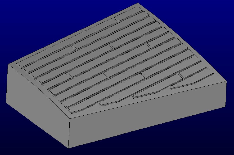

The steps to create planking detail that is proud is nearly the same except for its sort of a "negative" of the above process. This time starting with just the outline of the planks.
Heres how it looks after doing a group "extrude profile to solid"
To be continued again..
Best Regards
Fritz K.
PostPosted: Wed Oct 19, 2011 2:40 pm
Posts: 125
Location: Salem, MA, USA
OK Final demo post.. I promise.. :big_grin:
Heres the plank pattern after trimming the solids to the deck blank, and unstitching the lower faces.
Once again I have thickened the sheets into solids using a 'Both directions" option
And Finally, using Boolean add I attach them onto the deck.

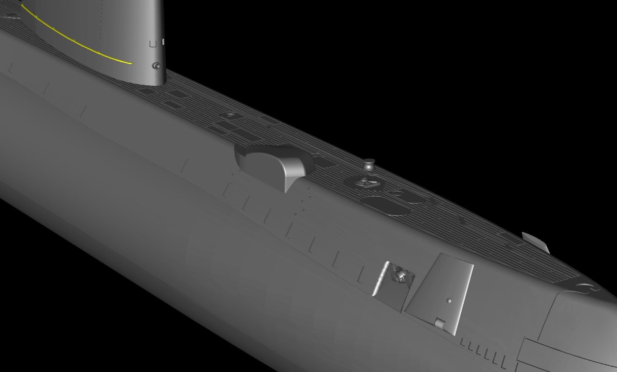

Now, as for the file size issue: The only advice I have for you is to stop just before the boolean step. I don't know about rhino, but we have a "subassembly" function. Certain Items can be exported as a sub assembly, and while still technically part of the file (a phantom bound box will be shown in their place) the assembley are stored separately, and the full detail (thus CPU hogging complexity) won't be loaded into active memory, unless you choose to deliberately view them, or actively edit them. I would suggest doing this with scribes/planks solids. Out of sight, out of CPU, until necessary. Then continue working with other items integral to the hull part (lower superstructures etc.). Wait until just before you intend to export the .stl file before attaching everything together. Then, yes you may have a huge file, but you only have to work with it for that one step. Once completed, save it separately, so If you decide to go back and rework something , you can do so with the original smaller and separate files.
Also, In our system, a huge CPU eater is doing booleans on complex, and compound surfaces such as hulls. In the case of a 1/700 battleship, for example, the transverse chamber would barely show up in the finished product. It may better not to introduce any transverse chamber at all. Any areas where the sheer is near flat, (like those in the big five) leave the deck planar altogether. This way the scribe edges data can be saved as linear (data size wise they get described as two connected points). Once you start doing this to a compound surface, each plank edge gets stored as a spline, which has MANY points..
HTH
Unfortunately if you're dealing with subs, this can REALLY cause a file to blow up like the relief planking, and limber holes on this one, simply beacause on a sub, EVERYTHING is a compound surface ;). Any edits to the hull part at this stage, and my quadcore 2 starts smoking..
