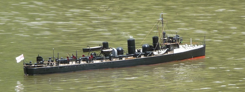

Armstrong 440
I think just about everyone's comments are on the right lines.
I have a little bit of experience under my belt having built some long slim shallow drafted working models.
Take a leaf out of the RC model aircraft builders hand books and "build in the lightness". Reduce the models weight "all over" by pruning every last ounce off the overall weight, paying particular attention to deck, deck structures funnels and masts. Reject all white metal fitting unless you absolutely have to.
This gives you the opportunity to then place the internal weight/ballast where it needs to be, low down on the hull floor (forward and aft if possible). Assuming your motive power is electric, go for 2 lead acid gel cell batteries laid on their side, one forward and one aft. This kills two birds with one stone. Instantly you have most, if not all the ballast, in the right place and lots of motive power. Check the dimensions of the batteries before you buy them and choose the biggest that you can fit in
If I can get a 1/48th scale HMS Velox (1904) to sail without bouncing up and down, I'm sure you can manage a larger vessel at 1/72nd scale. By they way you should not need to resort to either external keels or exaggerating hull depth unless you plan on building something very exotic or an aircraft carrier!
Good luck and keep us posted on your progress.
File comment: HMS Velox (1904) under way.
