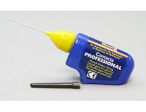

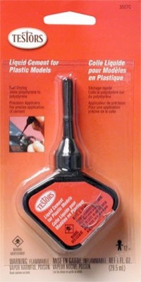

I agree with Timmy that the classic tube glue has a lot of drawbacks including weak bonds, slow drying time, "strings" and difficult to control the application (thus the need for and troubles with the tip). If you're not interested in a true liquid cement like Tamiya Extra Thin or Mr. Cement S, (both of which are excellent) you might like one of the mid-viscosity liquid cements like Testors Liquid or Revell Contacta. Both have a thin stainless steel applicator needle for good control, and as for viscosity both pretty much split the difference between tube glue and bottle glue.
