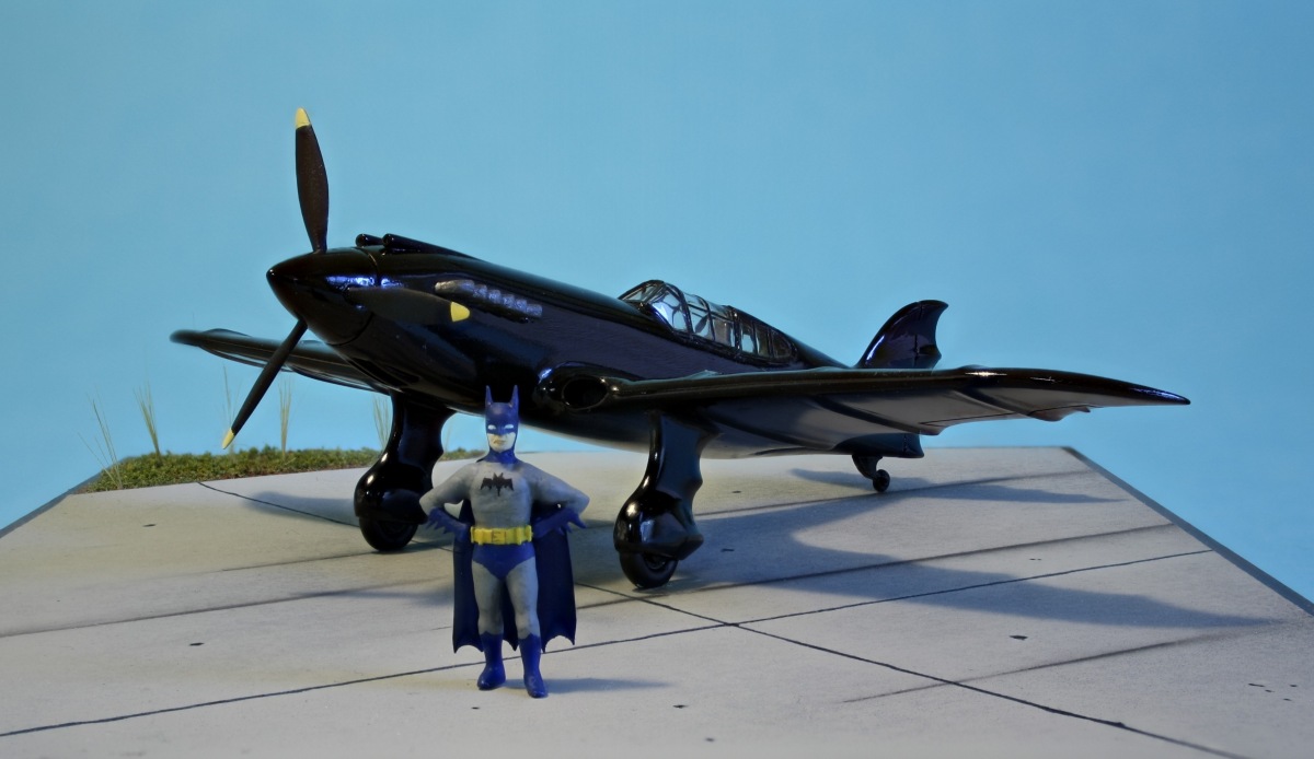

Focus stacking, even with automated remote control of the camera, does take more time and effort than just shooting a single picture. Is it worth it? I think so. Look at the pictures of the last half dozen or so models that Kostas has in the gallery to see how good it can look. Or, here is a sample comparison (sorry it's not a ship but I haven't shot any ship models yet using this technique).
File comment: The first sample picture is a single shot that has limited depth of field.
File comment: The second sample is a compilation of that first picture and 28 others, each taken at a slightly different focal length. As you can see, the digital processing produces a picture with depth of field far greater than would be obtainable otherwise, even using a very high F number and long exposure (the traditional way to increase DOF).

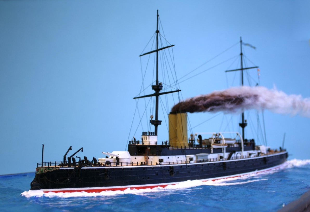

Here's a comparison that uses a ship model. I believe the effect is fairly dramatic.
File comment: A single shot in which the bow is in focus but the stern is not.
File comment: This is a product of focus stacking that includes the above shot.
