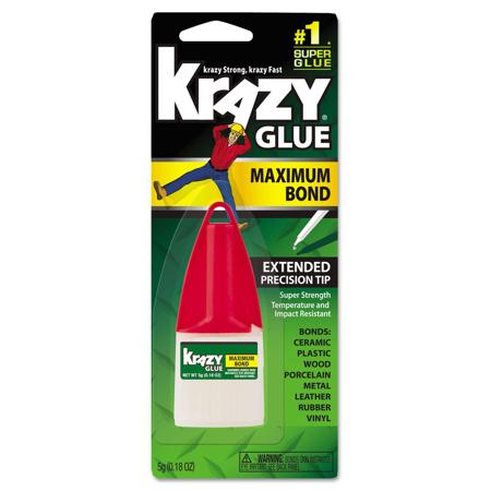

I've never had this particular style of container clog on me:
I also use the drop-on-a-palette method. A large rounded drop will survive a surprisingly long time.
