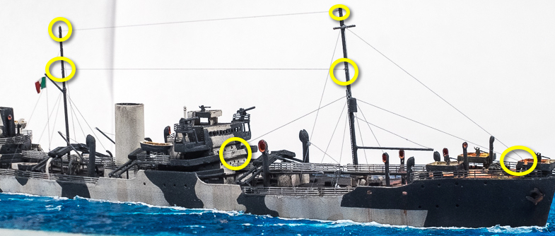

I used Usci Van Der Host 0,005 and 0,001. It proved great. It is flexible, elastic indeed, easy to fix and, being black, very realistic. See my Liberty Ship under torpedo attack in 2021 ship gallery (as Eugenio Lorenzini). It is 1/350, but works well as 1/700 as well
