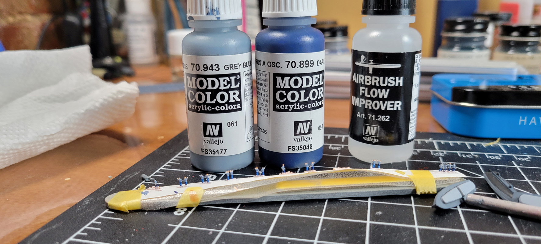

I go with Vallejo paints for everything. These are in 1/700 scale, but I find that Vallejo Grey Blue and Dark Prussian Blue work well for the shirts and trousers. I haven't gotten to the chiefs and officers for this build yet, but I always grab whatever looks good from my paint rack for that tan.
These are the 3D Model Parts figures, which are very nice. The only issue is that you have to prime them pretty well to get rid of the orange resin color.

Thank you for these suggestions, guys! I'll see if I can try them out.
Since asking my questions, here, I have gone with a few Model Master and a Vallejo (Air brush) paint colors. A bit of a mix and match of brands of acrylics. I switch up the shade of blue on the pants as well as the shirts. I have been using Model Master Wood as the flesh tone and have been happy with that. The khaki color for officers is Sand. Not too, fond of that, though.
