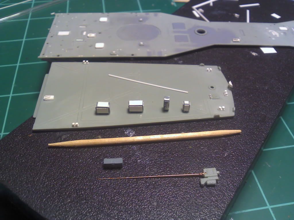

Hi, Welcome to the forum :wave_1: I'm building the Perry right now as she was when I was stationed on her. It is a learning experience for me as well but I would agree with previous posts. Do as much of the fine stuff in sub units as possible. I'm waiting right now for some more PE to arrive but I've got plenty to do with all the small stuff.
This shows some of the small stuff I'm working on

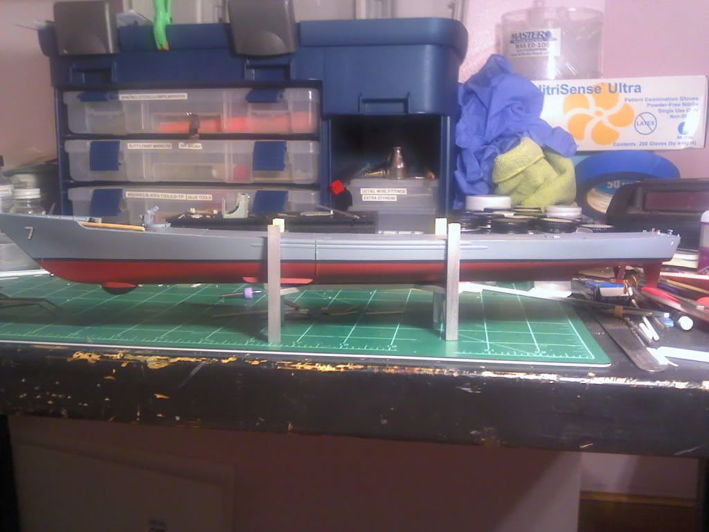

And this shows the hull in a holder I made up
Just take your time and look over the instructions often to plan ahead. I'm really enjoying this build even is it seems like a lot of work. I would also sugest joining a local model club if possible, the guys in my club have tons of experience and ideas for anything I might build.
