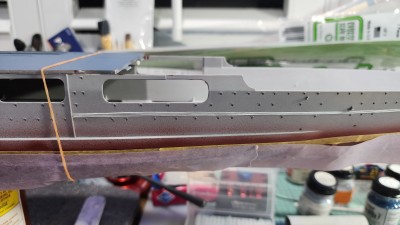

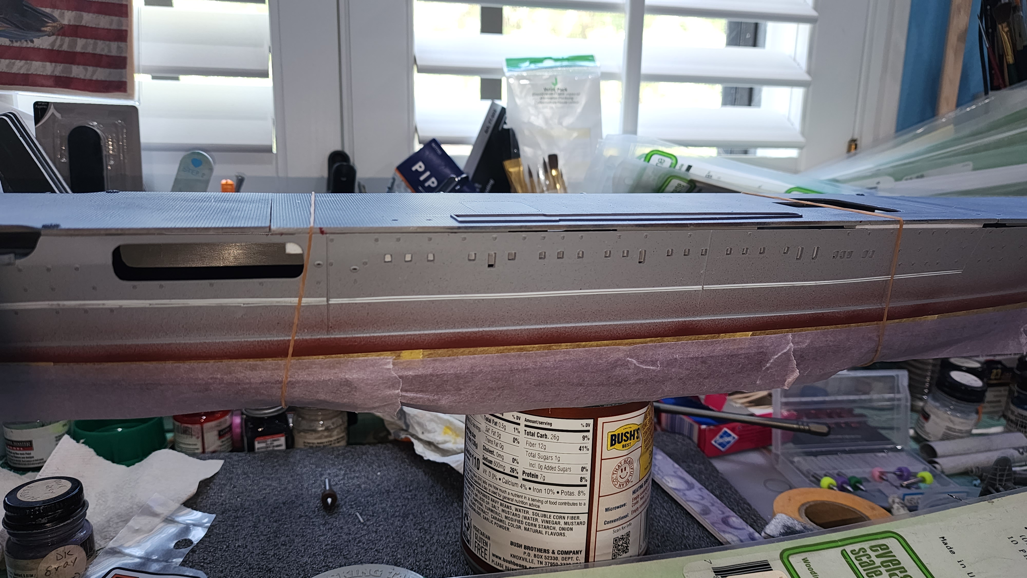

PostPosted: Thu Apr 17, 2025 3:42 pm
Posts: 571
This is the Trumpeter, 1/350, USS Lexington kit.
I am trying to replicate the degaussing cables on Lex. There are not a lot of pictures to go by. And they are of the Starboard side. Was the port side a mirror image? I hope so.
I am using the pictures of Enterprise to guesstimate a layout for Lex.
Looks ok to me, so far.
File comment: 4 cable, .010 rod degaussing cables. Running aft.

File comment: 2 cable, .020 rod degaussing cables midships.

PostPosted: Sun Jun 22, 2025 1:20 pm

PostPosted: Sun Jun 22, 2025 3:21 pm
Posts: 8342
Your guess is as good as anyone else's There are some picture in Stern's Lexington Class book, which seem to show the number of cables varied, depending where on the hull they were.
Chris Smithers built a 1/350 Lex and made an educated guess on the degaussing cable here: http://www.modelshipgallery.com/gallery ... index.html
His cables terminate at some point, though photos seem to show (IMO) that these angle up near the bow, under the forward 5 inch gun platforms.

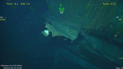

There are wreck photos too, but they only show snippets of the cable.
