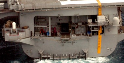

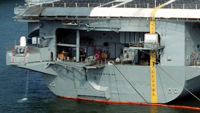

I've attached close up veiws of the fantail. I'd like to get an image of how it looked prior to 1979.
File comment: Close up view of the fantail on CVN-65 as she looked on August 14, 1990. Note the hinge-down stern dock installed in 1982 and replaced in 1995 with the style seen below. [Cropped USN photo by Don S. Montgomery]
File comment: View of the fantail as it appeard on August 31, 2003. [Cropped USN photo]

Hi Charles
You have helped me out so very much in the past about Enterprise research, I sure do appreciate that. Hopefully you can share some photos for this research project. :thumbs_up_1:
Charles, that second image above, the dome on the far right. What is it and when was it added? It looks like the that same dome you see added to the island in pairs. (Edit, I think I have an answer in your text above, it is part of the new landing radar added in 1994?)

Jon,
Looks like an SHF SATCOM dome. It was added after I left, but as you know all modern US warships now have a proliferation of domes. email off board and we discuss what you need for your project - crlandrum(at)earthlink.net

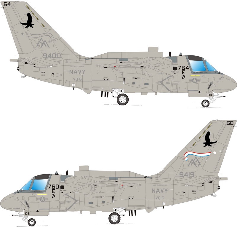

Charles, did you remember if the ES-3s had a different tail code? I've never seen a photo of an ES-3A with a CVW-17 AA tail code.

Here it is :
Art of my own for CVW-17 1996 Decals :

Patrice, that photo, note the refueling pod. They didn't have many of the ES-3s yet they had them doing refeuling duty. I'm sure the squadron didn't like that.
