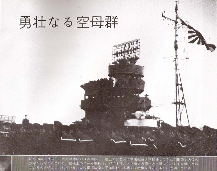

Hmm, missed this. Shokaku received her Type 21 radar post Coral Sea in July 1942, as part of her repair and refit. So, she wore it for the entire Guadalcanal campaign. Zuikaku received hers in early 1943.

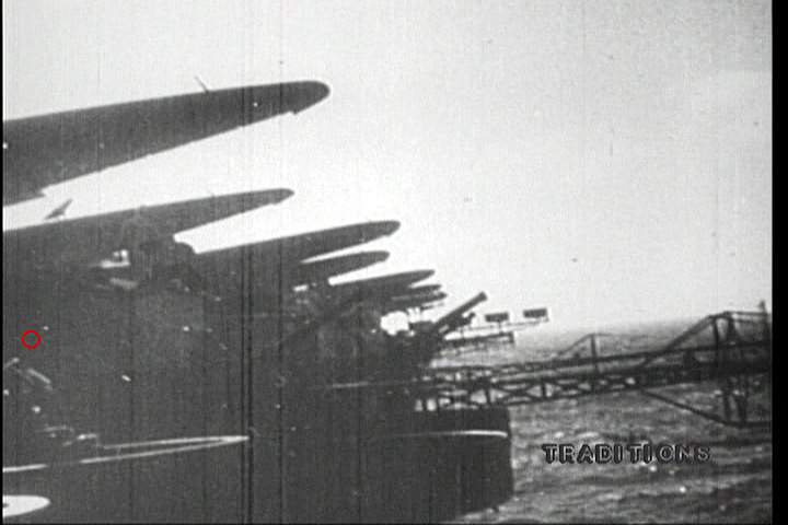

Below is a still frame from a movie taken aboard one of the sisters that I think is helpful to the placement of the starboard landing light array. The horizontal placement of the 4 light array is considerably above that of the radio masts, pretty close to the level of the flight deck. So, it would appear that the supporting girder is attached to the forward end of the galley platform in that location. I just don't think there's room to squeeze the girder thru to the hangar sidewall.
Separately, the red circle indicates one of the 25mm directors, open in its tub. I think it's called a Type 95 Shiki Fire Control director.
