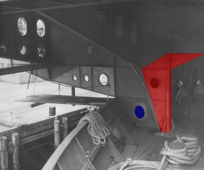

If you want to be REALLY anal about your Gambier Bay build:
1) drill a hole on both sides of piece C17 where the blue spot is. This was present on all of the ships but missing on the part.
2) The red area was added as a ShipAlt starting with CVE-94 USS Lunga Point. I don't know if it was retrofitted to Gambier Bay but I can see from the AOTS Gambier Bay book on page 27 that she did not have it originally.
File comment: Unknown CVE, possibly CVE-94
