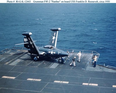

This image of Franklin D. Roosevelt circa 1950s, also from Ray Bean's set, also seems to show fore-and-aft planking.
File comment: From Ray Bean's Midway set
PostPosted: Mon Nov 11, 2024 2:52 pm
Posts: 498
I'm pretty certain it is not planking but anti-skid mats due to the layout.
