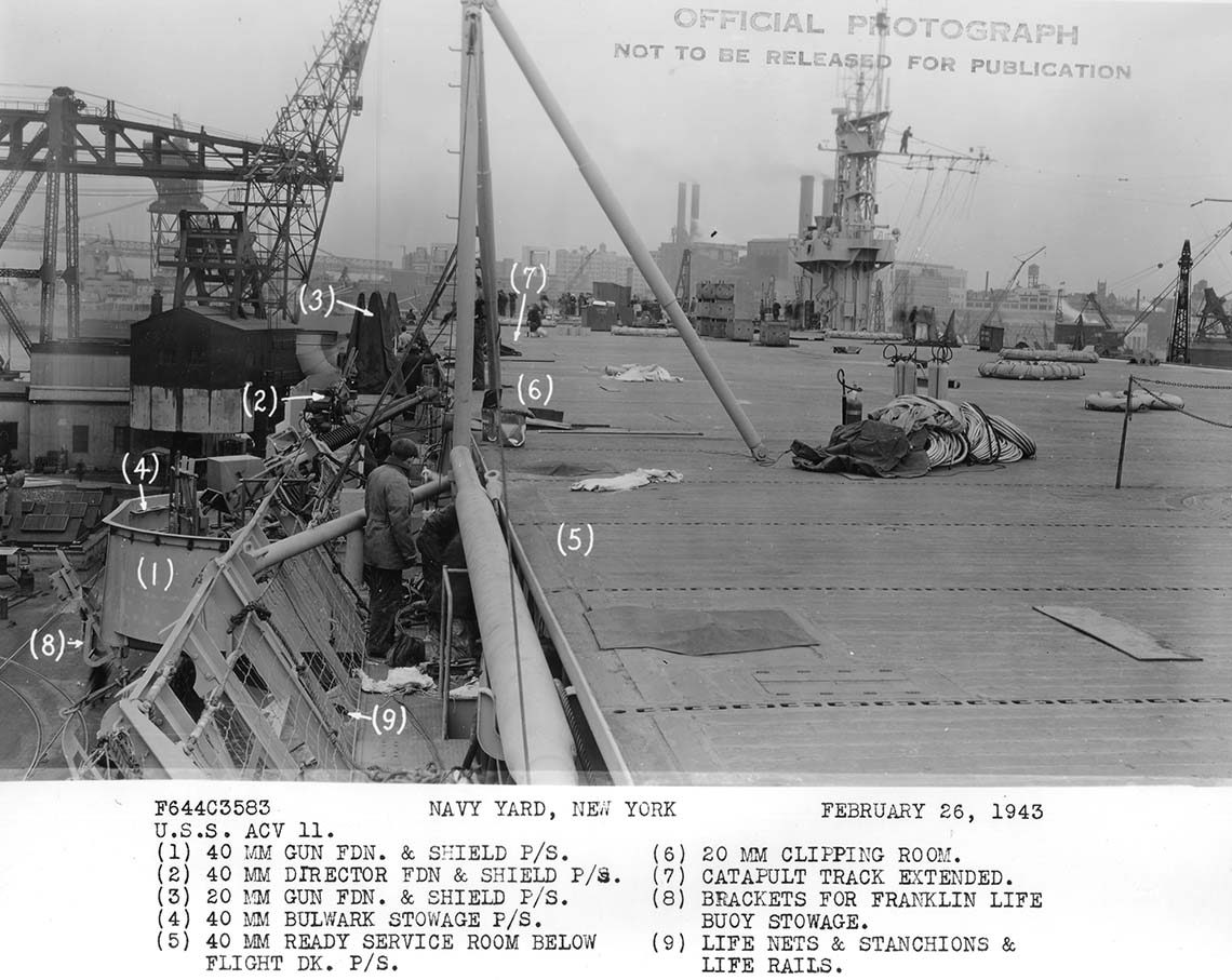

Can anyone confirm (or deny) that the railings on the flightdeck catwalks on the Bogue class (both US and British) CVEs were angled 45 degrees outboard? I have read this somewhere, but have not seen enough photos to be convinced.

PostPosted: Tue Aug 20, 2019 8:16 am
Posts: 10569
Location: EG48
I'd say more like 60 degrees. Not all sections either, the corners on at least some were vertical and the catwalk under the aft flight deck had vertical railings since it was hanging from the overhead. I haven't done a study yet to see if this was an evolving feature.
