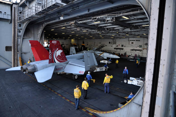

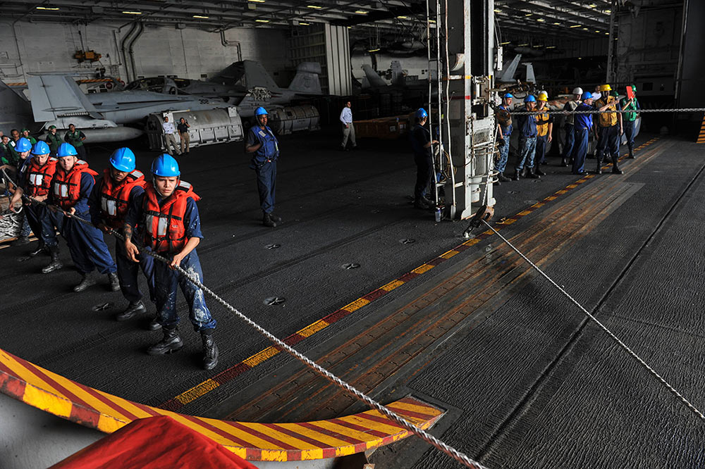

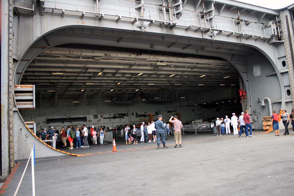

Thanks guys for that information. For my hangar deck, I am only going to have the two forward most elevators on the starboard side of the flight deck in the lowered position and those bay doors open, so this is the only area that needs to have any scratch built details added, and I'm not lighting it so it will be dark inside, so accuracy is not really as important as simply looking believable. Are there any decent photos of the portside hangar bay bulkhead in the area directly opposite the two starboard forward hangar bay doors?
for the overhead, I'm just going to install some thick styrene strips to the underside of the flight deck to represent longitudinal beams. Again, doesn't need to be super accurate, just believable.
I believe that one of the sets of retractable partitioning doors that divide up the hangar bay into three sections, is located in between the forward two hangar bay doors?
Thomas E. Johnson
http://www.youtube.com/user/ThomasEJohnson
PostPosted: Fri Mar 27, 2015 11:20 pm
Joined: Sun Jan 25, 2015 12:11 pm
Posts: 100
Location: Niceville, FL
Here's one :thumbs_up_1:
File comment: From elevator 1.
PostPosted: Fri Mar 27, 2015 11:26 pm
Posts: 100
and another...
File comment: Looking forward from elevator 2
PostPosted: Fri Mar 27, 2015 11:28 pm
Posts: 100
and finally :cool_2:
File comment: Looking aft from elevator 2
