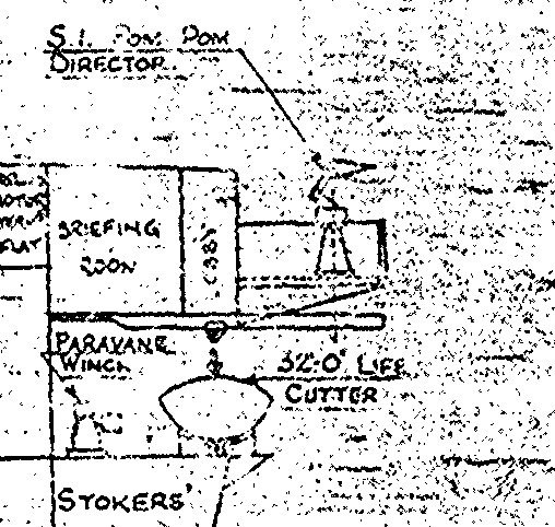

Hey Al, I have been using these plans a lot last year when working on my HMS Glory build. The only markings I could find are a simple P1.2...for the port side directors and S1, 2 etc.. for the starboard side. Glory lost her directors before the Korean war so I did not need more information.
This is another cutout of the drawing, maybe this can help you identify the type.

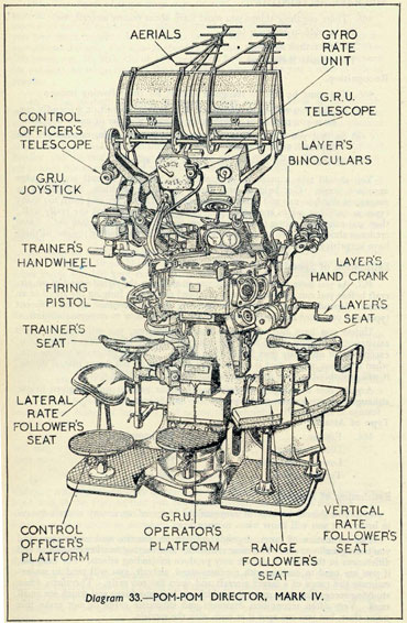

Thanks, Pieter!
Mk IV director I quickly found through Wikipedia.
These are available from MicroMaster in 3D print, scale 1:350.
https://www.shapeways.com/product/MCWWJSGCX/1-350-royal-navy-mkiv-pom-pom-directors-x4
You can ask Simon if these could also be printed in 1:700.

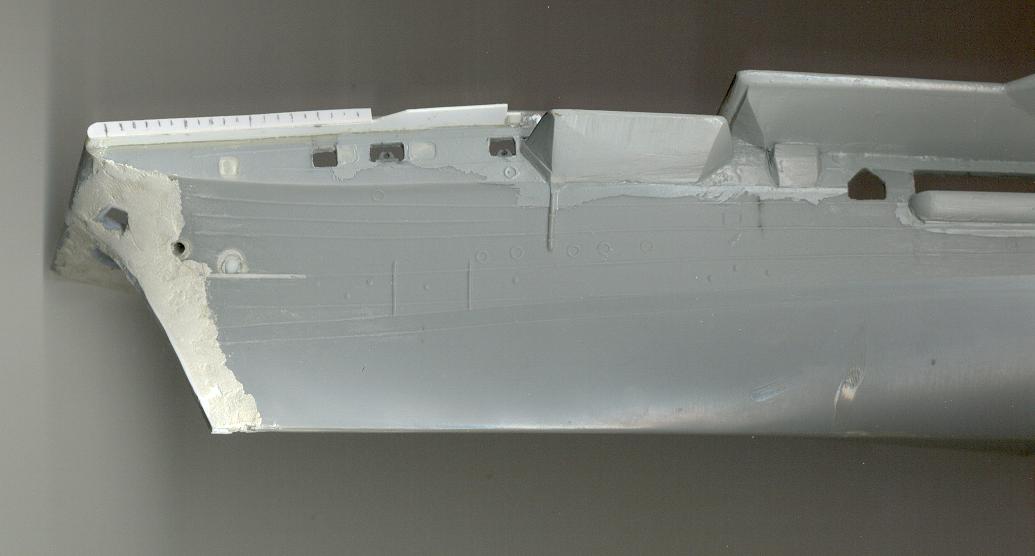

Well, it is, but it has only one nasty error:
The stem (sharp edge of the bow) is about seven mm too far to the rear. The curve of the stem is therefore much too pronounced.
Knowing this, it is not difficult to correct, by adding a strip of plastic of 7mm width, filing and sanding to shape, blending in with putty. Like this:
Final sanding is still required. Note that the anchor hawse pipe is also in the wrong location and needs to be placed much more forward. This was how I discovered the error: I made a forward deck according to the plans, and the anchor hawse pipes ended up far forward of those in the hull! What was wrong??? Apparently: the stem.

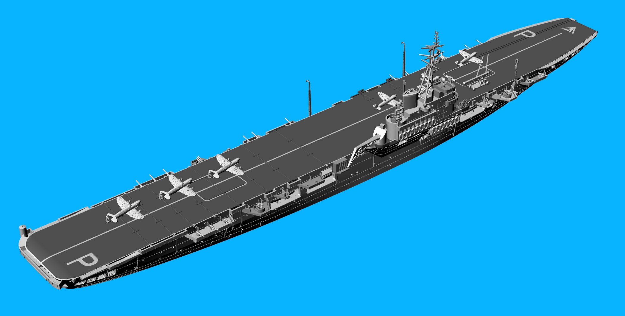

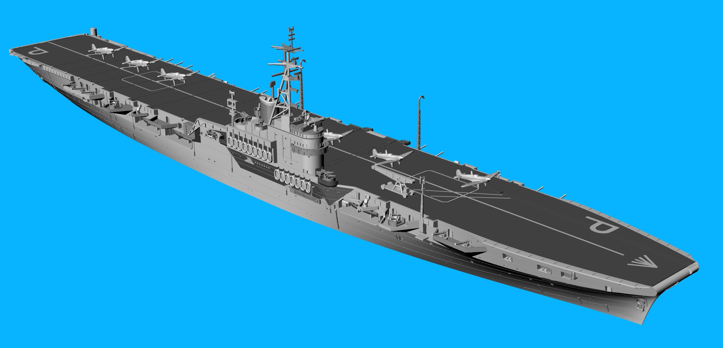

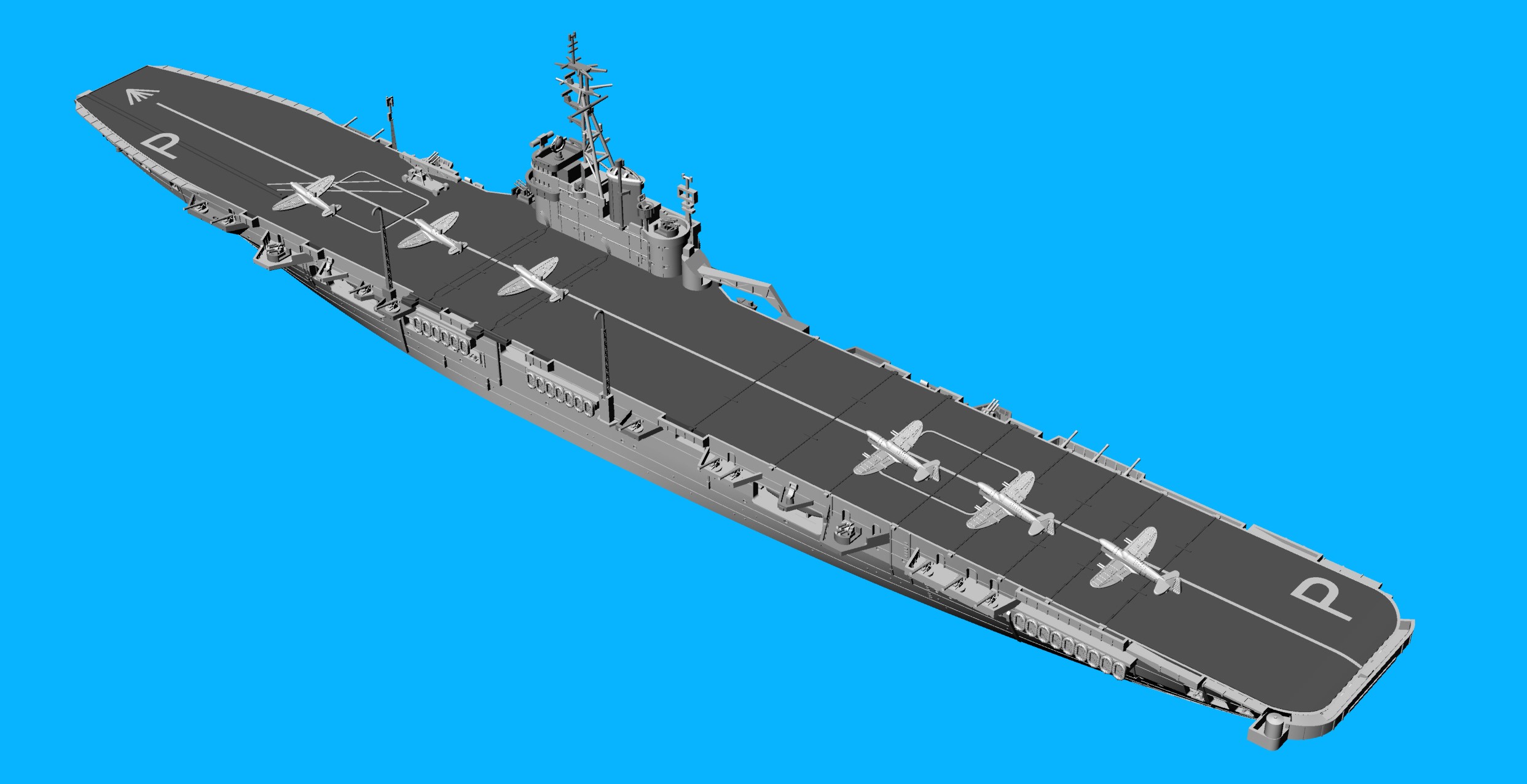

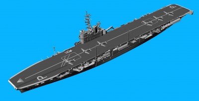

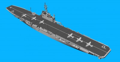

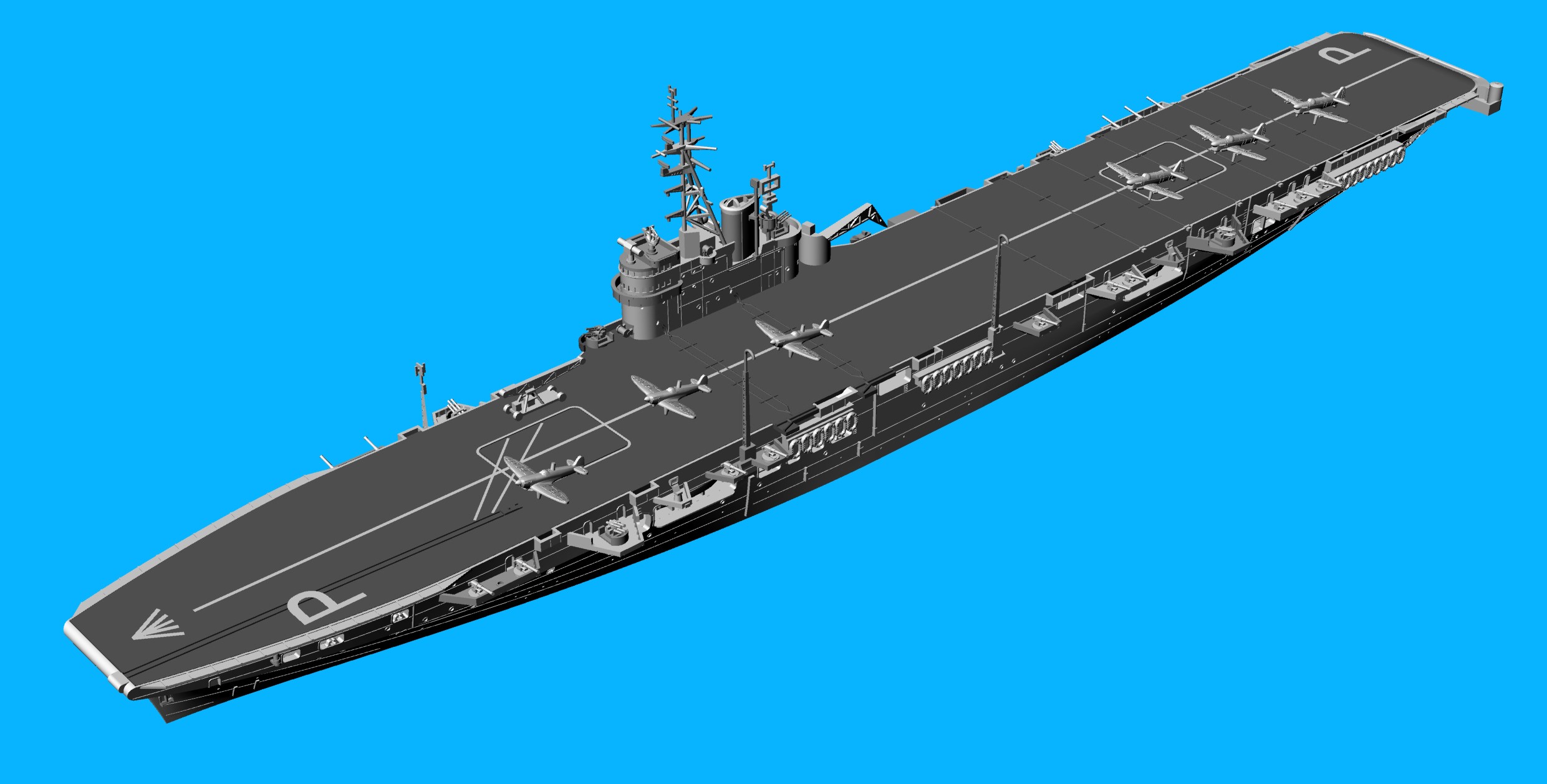

1/700 Triumph is the next Colossus variant from IHP. Kit will represent the ship in 1946 and will feature enclosed bridge, stern flight deck walk, YE antenna on funnel moved from mast, changes to AA and radar fit, more MKIV directors and a complement of Seafires and Fireflies. A decal sheet for the flight deck markings, BPF markings for the aircraft and the White Ensign will also be included.

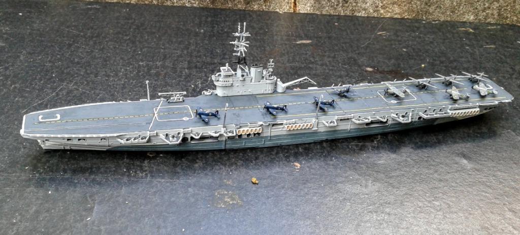

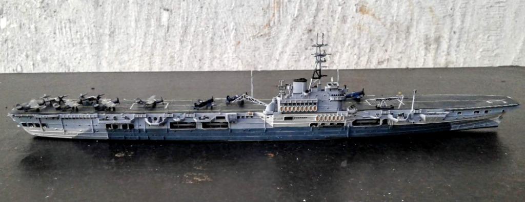

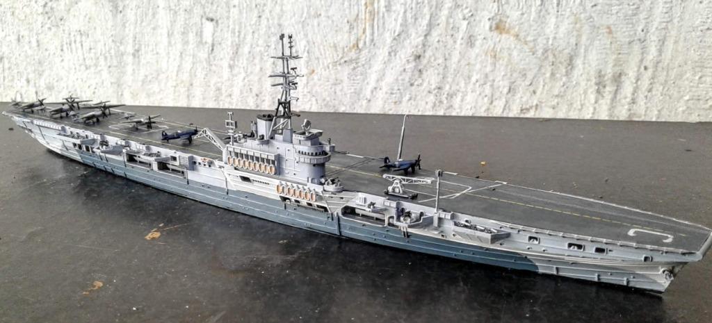

Hi all,
Thought I'd share what I did with my Colossus kit - 1945 in the paint scheme shown in the photos posted above - thanks to TJ Stoneman for helping with the correct colours (G45, B20 and white). Very similar to Glory's 1945 scheme.
I used some Corsairs from the parts stash, and made my Baracuda's from Trumpeter Helldivers! I think the aircraft roundels may be wrong, but I used what decals I had.

Paul - that looks good!
PostPosted: Wed Apr 07, 2021 7:01 pm
Posts: 8826
Better than good.

It does look really good. I might offer some BPF decals separately if there's need.

Thanks guys!
@Mike, appreciate the offer, but it's already done and I'm happy with the look. :big_grin:

Nice to see another Colossus build. Excellent result, Paul.
