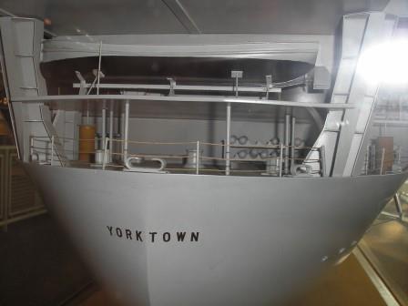

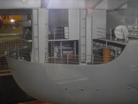

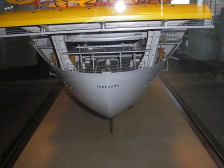

Here are some compressed pictures of the YORKTOWN Builder's Model showing YORKTOWN pretty much as built - late 30s. Hopefully the pictures are good enough to see the features.

Again, they sure look like (empty) drop tanks to me - probably for SBCs.

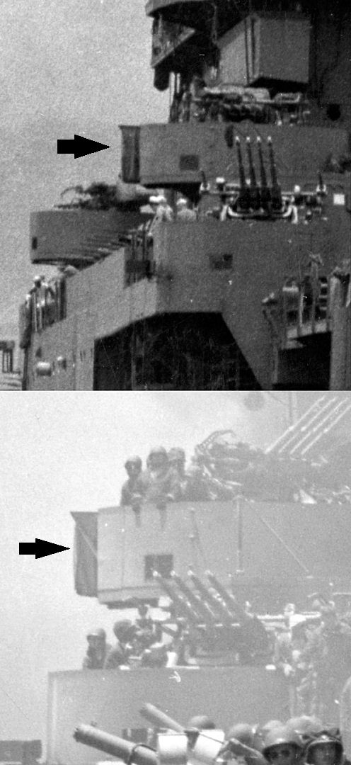

I came across this cracking photo of a Yorktown class carrier online. It claimed to be of Yorktown, but after reading the various info posted in this thread, I think it may be Enterprise due to the 20mm tubs forward of the main deck crane (I thought Yorktown had 8 x .50 cals on the stb side). However, the 20mm gallery on the stb island looks to be like Yorktown.
Also, is it Measure 12 camo? That would surely be definitive.
Does anybody recognize this photo? If so, do you know the time frame it was taken?
Also... it seems that the .50 cals were fitted with splinter shields like the 20mm (??)
You are right, that's Big E. The aircraft by the round-down are Avengers. Yorktown was lost before receiving that type of torpedo bomber. Photos of the wreck show that Yorktown's degaussing cables are continuous at the stern, not split like here.
Great photo!
This photo is Enterprise, returning to Pearl Harbor after Eastern Solomons, and she wears Measure 21 Navy Blue. Note the damaged 5 inch battery, which was hit by a bomb in the battle. Also, the aft corner tubs are upgraded and mount 20mm guns. The original 50 calibers were in the catwalk, not mounted in tubs notched into the aft ramp. (Hornet had same aft corner 20mm tubs). At her repair period prior to return to South Pacific, an additional 20mm was added inboard of these two corner ones.

A couple of interesting points; I notice no number 6 or a name plate across the stern. Censored perhaps or was CV-6 different from her two sisters in this respect? Do you know what the small ring is just forward the aft 20mm on the stb side? There also seems to be a small overhang around the base of the crane on the main deck. I'm sure this wasn't as built.
Thanks again.
