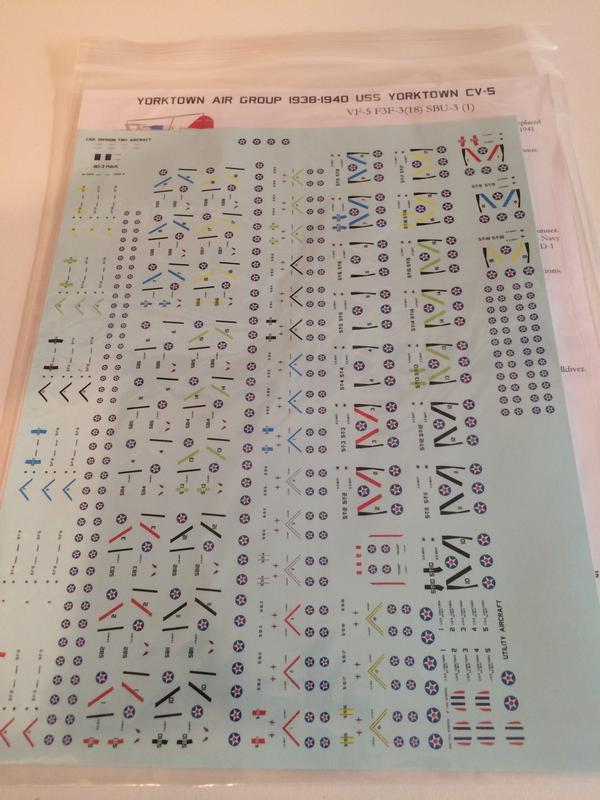

I emailed Mark from Starfighter a couple of weeks back about Ranger decals, which he didn't have, but in conversation it turned out he does have 1/350 decals for pre-war Yorktown, though they are not listed on his site:
