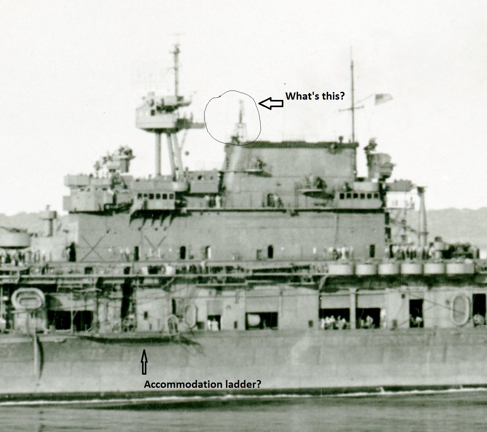

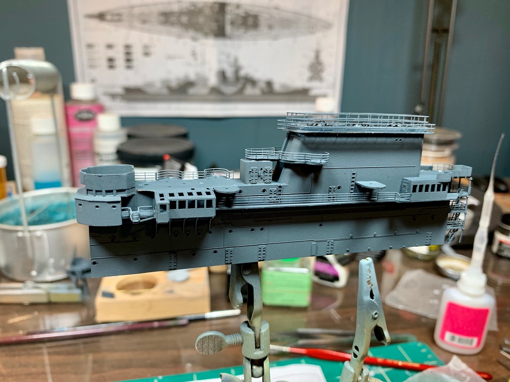

Continuing work on the Merit 1/350 Enterprise. Working on the island. Anyone know what the object on the forward top of the funnel is?
File comment: Crop of photo 80G-641191 Enterprise Nov 1942, US National Archives
Here is where I'm at with the island

PostPosted: Fri Aug 02, 2019 4:57 pm
Online
Posts: 1610
Location: The beautiful PNW
Martin,
It’s a Radar. I missed it in my build but the Infini set included it.

PostPosted: Fri Aug 02, 2019 11:24 pm
Posts: 3841
I'm not certain because USS ENTERPRISE had mods done post the Battle of Santa Cruz, but the three YORKTOWN class carriers had an early IFF system installed post Pearl Harbor Attack in early 1942. There were several different systems in use that tried to perfect the application (there were at least seventeen different systems built in 1941-42; BA, BE, BE-1, BF, etc). I don't know which one(s) were actually installed on these carriers. It appears that the antenna looked similar to the SC radar. These "standalone" IFF antenna systems weren't satisfactory and were replaced with IFF antennas attached to the search radar and fire control radars. Eventually, ENTERPRISE and the ESSEX class carriers had a secondary SC-2 radar installed.
Here are photos of a US Army IFF antenna (and system) that is on display at the Military and Space Electronics Museum near Baltimore. The Naval version may have been different, but had to be have been similar because the IFF frequencies were the same. You can see that the antenna seen in the WWII period photo is structurally slightly different than the actual antenna on display. But, it shows that the dipole and mattress reflector antenna design was used.
