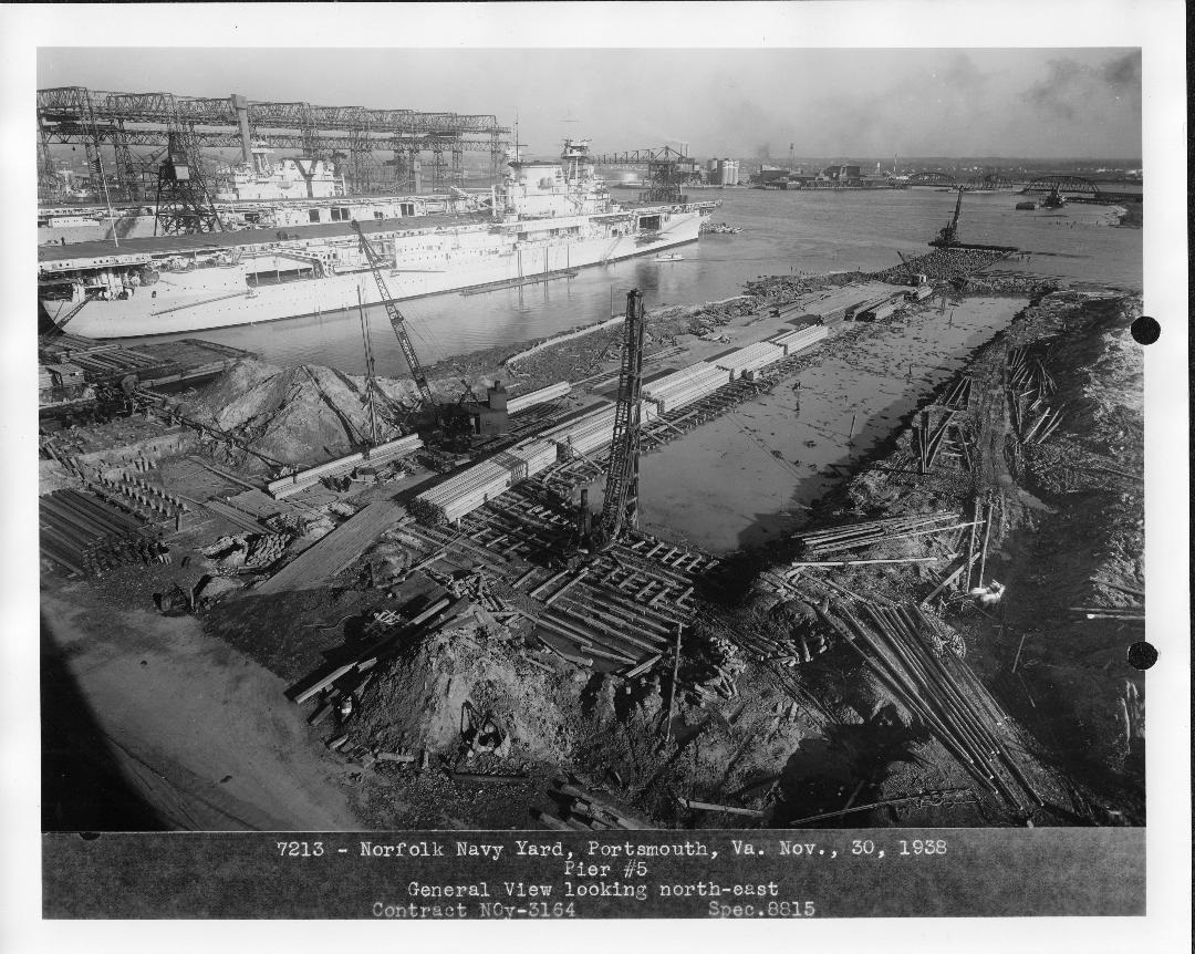

PostPosted: Tue Feb 11, 2020 7:47 pm
Posts: 8349
USS Enterprise at Norfolk Navy Yard, November 1938. Note Yorktown in the background. Photo from National Archives NARA II, RG 71-CA (Yards and Docks), courtesy of Roger Torgeson.
