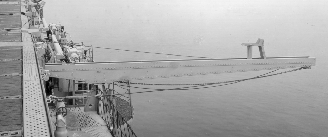

PostPosted: Sun Apr 04, 2021 3:07 am
Posts: 1881
Location: Bretagne, France
Does anyone have a more accurate picture or information on this bunker hose support? Is it an articulated arm?
My project:
viewtopic.php?f=59&t=306241
Pascal
PostPosted: Mon Apr 05, 2021 10:57 am
Posts: 1975
The primary purpose of this structure was not as a hose support. It was one of 10 "outriggers" that were designed into the Yorktown class - 4 to starboard and 6 to port. The actual purpose was to support the tail wheel of an aircraft. The outrigger would be positioned perpendicular to the deck, the tail wheel would be attached to a slide on the outrigger and then the aircraft would be pushed back until the tailwheel reached the end of the outrigger. This increased the deck-spot capacity of the flightdeck and allowed some "ready" aircraft to be stowed out of the way of the remainder of the deck load. The numbers of outriggers were reduced as the 20MM fit was increased and eventually, all were removed from Enterprise. Yorktown and Hornet still had a few when they were lost.

PostPosted: Tue Apr 06, 2021 5:17 am
Joined: Tue Jan 06, 2015 5:28 pm
Posts: 101
I can see from your work that you are a man for detail and I thought you might like this...
The same outrigger system on CV-7 (photo via John Sheridan/National Archives)

PostPosted: Tue Apr 06, 2021 6:27 am
Posts: 1881
Thank you, it's the picture I was missing for the pivot axis. :thumbs_up_1:
Pascal
PostPosted: Tue Apr 06, 2021 9:09 am
Posts: 1881
This outrigger is drawn, I simplified it a bit due to the constraints of 3D printing at 1/200 and my railings already in place.
