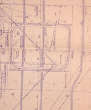

Here are scans of a plan showing some of the tracks (plan orientation = aft top, forward bottom).

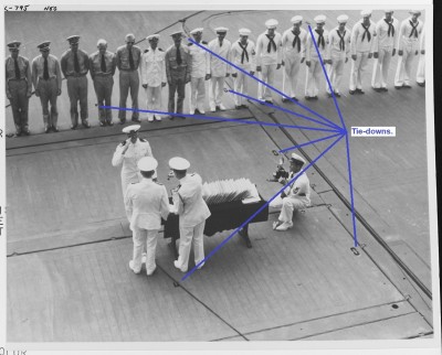

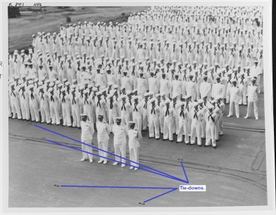

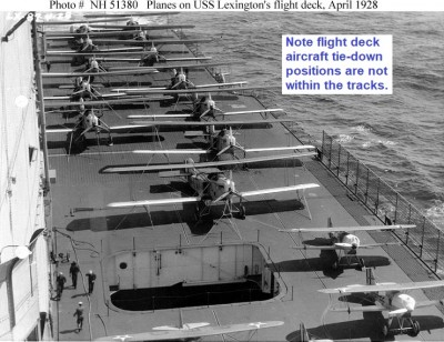

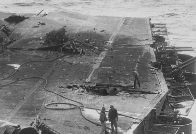

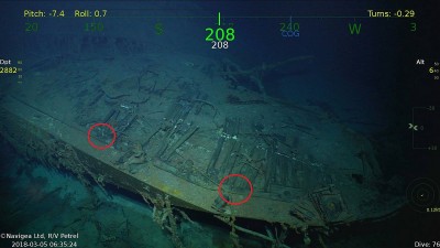

PostPosted: Sun Feb 09, 2020 8:03 pm
Posts: 4046

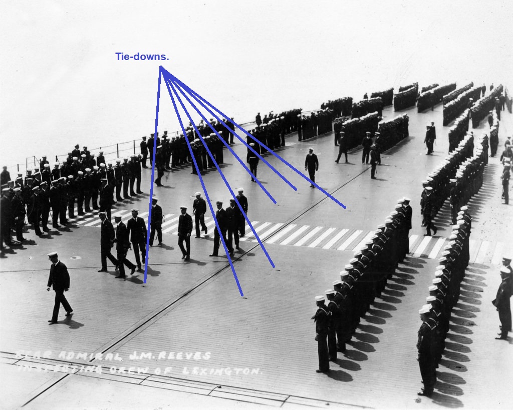

Unlike what we see in photos of the hangar deck, flight deck tie-downs were steel devices built flush with the deck. There are two types visible in photos, single-horn and double-horn. They were very small. The double-horn tie-downs are appear shorter than the length of a man's foot and appear narrower than the planks they were positioned within.
Wreck photos indicated that the tie-downs located at the edge of the flight deck are oriented differently. They are positioned inboard of the waterway and oriented parallel with the edge of the deck rather than parallel with the deck planks (see bottom photo, posted here under fair-use).
