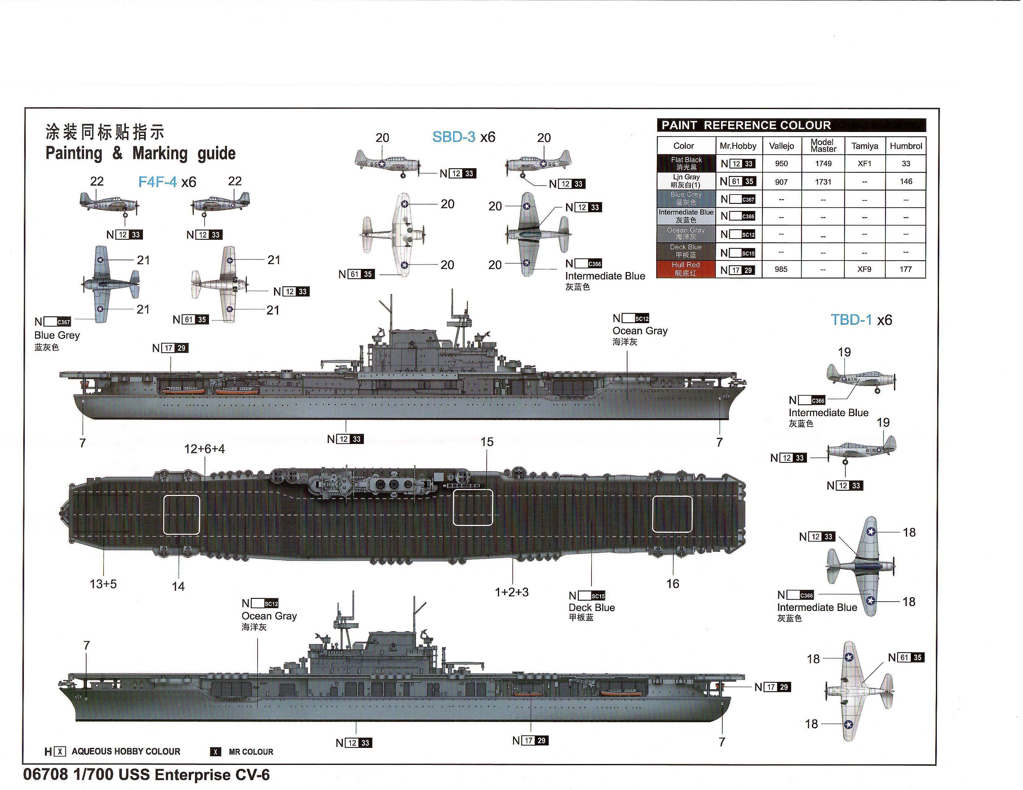

Could somebody help me of what year represent the 1/200 scale CV-6 Enterprise Trumpeter kit?, I was looking the paint instructions that comes with the kit and is showing Ocean Gray 2157 for the entire carrier, red at the bottom of the hull and Deck Blue 2159 for the deck, I was checking the guns location at the 1942 and is showing more but less than the 1944 (Gordon G. Buttars), the attached image is from the 1/700 Trumpeter kit that I have and it is showing the same amount of guns.
Thanks in advance
Alex

Base on my review of the Trumpeter 1/700 CV-6 kit, I have the following:
(8) 5" 38-Caliber Dual-Purpose Gun
(1) Quad 1.1" 75-Caliber Cannon
(4) Bofors 40mm Cannon
(47) Oerlikon Single 20mm Machine Gun
the parts are to small to compare with the real images but for the amount of guns looks like the configuration of this kit is for 10/43 if you think the same.

PostPosted: Tue Dec 19, 2023 11:45 am
Posts: 8339
I belive the kit represents the Big E at the Battle of Santa Cruz in October, 1942, but is missing the radar that sits on a platform on the starboard side of the island. Aftermarket sets may have that included.

(4) quad and (4) twin Bofors 40mm Cannon.
PostPosted: Tue Dec 19, 2023 6:35 pm
Posts: 1975
She had 4 quad 40MM and one quad 1.1 (on the bow) at that time. The painting guide drawing shows a number of errors for Enterprise in that fit, including (but not limited to) the degausing cable arrangement, the upper bridge, and the radar outfit, part of which Martin already mentioned.

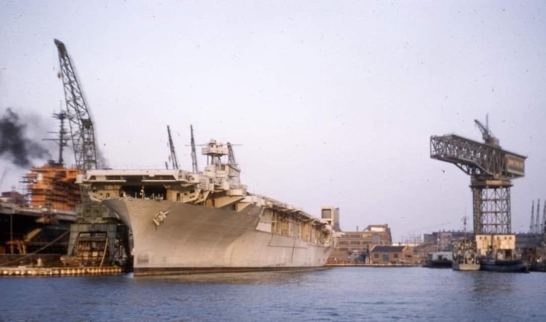

From the USS Enterprise (CV-6) Facebook page:
USS Enterprise (CV-6) alongside Pier K at the Brooklyn Navy Yard in New York in June 1958. She was sold on 1 July 1958 to the Lipsett Corporation of New York City for scrapping at Kearny, New Jersey.
This rare color photo of post-war Enterprise gives a good appreciation of the blisters that were added to her hull in 1943.
PostPosted: Thu Dec 21, 2023 7:46 pm
Posts: 8339
DavidP wrote:
Martin, no blister is shown on the portside as only starboard side would be visible as visible above waterline.
Dude - I just reposted what the CV-6 FB posted. Thought people might find it interesting. I certainly had not seen this picture before.
PostPosted: Thu Dec 21, 2023 10:47 pm
Posts: 1975
Are you saying that there was no blister above the waterline on the port side? That is incorrect and a port side blister can clearly be seen above the waterline in the referenced photo. Unlike Saratoga, Enterprise's blisters were symmetrical.

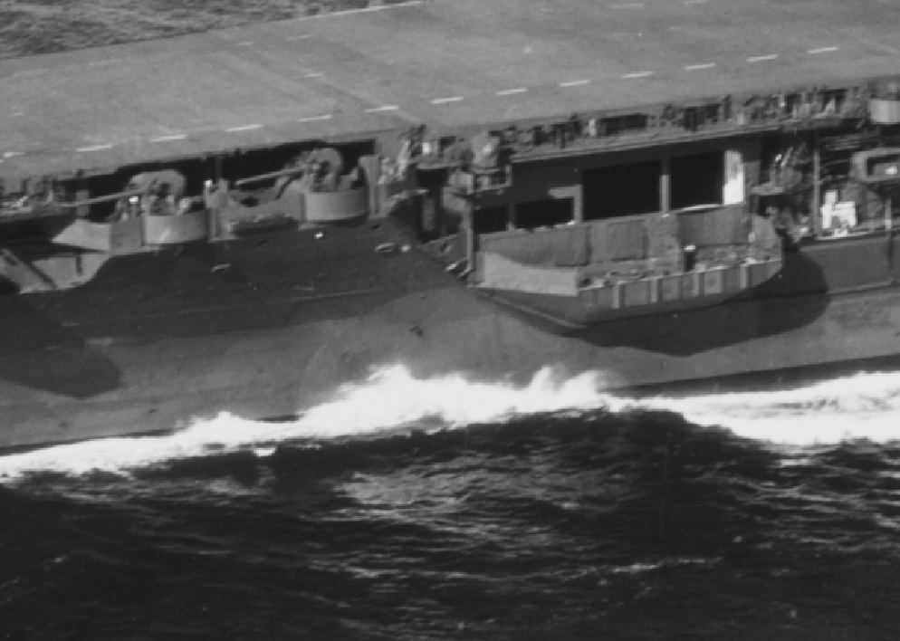

PostPosted: Fri Dec 22, 2023 5:03 pm
Posts: 12325
Here's a good shot showing the port blister: https://www.history.navy.mil/content/hi ... 89185.html
Suspect DavidP thinks the blister was the typical low-to-the-waterline affair that's only visible amidships rather than this much higher and forward affair.
PostPosted: Fri Dec 22, 2023 8:12 pm
why is Sara's starboard blister more massive then her port blister?
The weight of the island and the heavy guns gave the Sara a list to starboard (about 3 degrees). The larger blister was to correct this.
