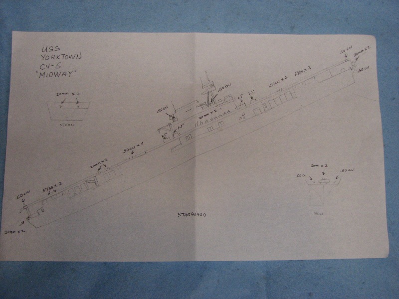

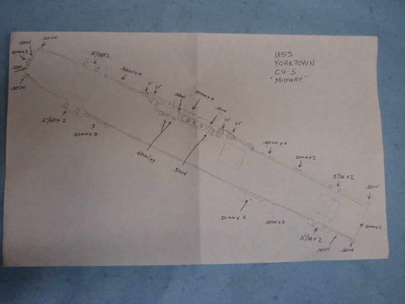

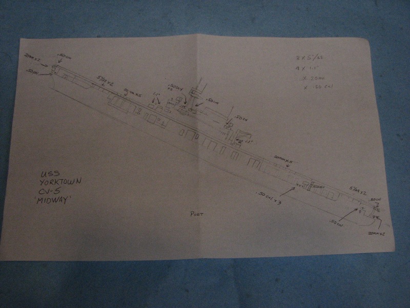

I'm looking for confirmation or correction of Yorktown's 20mm and .50 cal guns at Midway. Following Dick J's posts on the SN site dated 12-17-03 and 11-10-05, this is what I came up with. I hope that I read the posts correctly.
TIA
Gordon
Last edited by Gordon Bjorklund on Tue Nov 26, 2013 9:13 pm, edited 2 times in total.

PostPosted: Sat Mar 17, 2007 11:47 pm
Looks good to me. A couple of additonal hints, though. Watch the positioning of the 1.1's forward of the island. The one on the clipping room roof (#2 mount) is usually depicted with the tub overhanging the front of the structure. Actually, the front of the tub was set back from the front of the structure. (Enterprise was built the same way, but when she got the 40MM, the position was moved forward. Hornet was built with the more forward position.)
Also, in Ballard's Midway book, illustrations show what appears to be a third 20MM pedestal on the fantail (on centerline). What I believe this to have been was the support bracket for the jettisonable 800 gal avgas tank added just prior to Midway. The tank itself was dumped when the IJN divebomber attack group was detected on radar.

Dick,
Thank you for your quick reply and thanks for the earlier posts on the SN site a couple years ago. I didn't understand the layout the first time I read your post but after drawing out the outline of the ship and reading your post it started to make sense. Over the years I saved all the posts on Yorktown class carriers I came across. They have come in handy. Now I have new info.
I will change the position of the 1.1" tub on top of the clipping room.
Now on to the location of the rafts.
Thanks again for your input.
Gordon

PostPosted: Sun Mar 18, 2007 11:59 am
Hi Gordon,
As for the rafts, off the top of my head, I can list a few. There were some large rafts located below the island, just above the hangardeck level. They were attached to vertical posts running from the hangardeck to the overhang outboard of the island that had housed the boatcrane machinery. These rafts were doubled, but I would have to review my sources to get the exact number of sets. Four small rafts were located on the outboard side of the island itself, at the after end.
Good luck on your researches! :thumbs_up_1:

PostPosted: Sun Mar 18, 2007 12:51 pm
Yorktown was built with 24 .50cal mg's. 16 were in the flightdeck catwalks in groups of 4. One group was located to stbd, just forward of the island and the forward 1.1's, another stbd aft, behind the after 1.1's. The other two groups were to port, opposite the stbd groups. 4 more .50's were located on the island, 1 ea inboard and outboard of the tripod mast, and inboard and outboard between the back of the stack and the after MK-33 director. The last 4 were located in the foretop. When radar was added, the 4 foretop mounts were relocated to the 4 corners of the flightdeck. All 24 mounts had permanently installed cooling systems.
In Dec '41, 24 20MM were installed, and were intended to replace the .50's. However, in the confusion, Yorktown kept both. Only 8 of the .50's were actually displaced - the 8 in the port catwalks. The remaining 16 remained permanently installed, although the guns themselves could be removed and stored.
The 24 20MM were located as follows: 5 ea replaced the 4 ea in the port catwalks. 8 were outboard of the island, evenly spaced between the front of the island and the 4 rafts at the after end. 2 were located in the catwalk above the stbd hangar level boatcrane. 2 were added on the bow bandstand, and 2 on the fantail.
The 8 displaced .50's were positioned as follows: 1 each on either side of the bow 20MM bandstand, 2 on the island forward of the permanent inboard .50 abeam the tripod, 3 at hangar level, forward of the port boatcrane, and the last one immediately behind and one level below the port after 5" gallery. These temporary mounts had no cooling hardware, so corks were put into the connections for the cooling hoses. When the heat popped the corks, the cooling jackets were refilled using tea kettles, and the corks reinserted. The gunnery officer wasn't sure if the Navy would take the .50's back, so they were usually "stored" whenever Yorktown was in port. (Which is why the bow mounts don't show in the famous drydock photo prior to Midway.)
All of the .50's and the two fantail 20MM were protected only by splinter mats attached to the lifelines. (The 20MM did have the on-mount panels, like all the other 20MM.) The remaining 22 20MM had fixed splinterscreens in addition to the on-mount panels.
Gordon's drawings should help all this to make sense.

I have a scan of 80-G-21644, which is close to the same view as 80-G-21666. Here's a cropped copy of the full-screen shot:
In the photos I have, I can see three outriggers, so I'm fairly confident she had four to be symetrical.

Yorktown had eight outriggers at Midway! I thought she might have four and that they were all forward. Your answer sent me on a quick quest on the web but no luck. Then I remembered you said she had ten when built, that sent me to Roger Chesneau book "Yorktown Class Carriers" and Stephen Allen's 1/480 Yorktown. Well lo and behold there are ten on his Yorktown. Once I knew what to look for they was easy to spot.
John Lundstrom's book "Black Shoe Carrier Admiral" was brought to my attention at our local IPMS meeting a couple of weeks ago. I"ll have to check to Library to see if they have it on the shelf.
I'm still not certain on the raft situation.
1. I can't tell by the dry dock picture whether there are four or five large double rafts on the side of the hull. I made up five sets.
2. The four small rafts on the island must not be mounted to high off the deck.
3. I see that there is a stack of rafts on the port side hangar deck just below the rear 20mm gallery.
4. I see that there are to sets of rafts (one set of three small rafts and the other is a large and small raft) at the stern on the port side at hangar deck level.
I also don't see the small forward crane outside of the island in any of the pictures i've looked at. Was it removed or have I missed it? There's not many if any closeups of the starboard side that I have seen.
Thanks again for your response.

Thank you for the picture. That outrigger is sure visible in that picture. The location of the .50 cal mg's is also clear. The picture shows that the stack of rafts on the hangar was used by the crew when they abandoned ship. They are not in the picture.
Thank you again for taking to time to help me..
