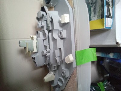

My BB 59 3d printed superstructure wood printed deck
SOUTH DAKOTA SUPERSTRUCTURE AND Hull RESIN FROM MOLD
PostPosted: Tue Sep 03, 2024 1:02 pm
Posts: 5060
What is the scale here?
