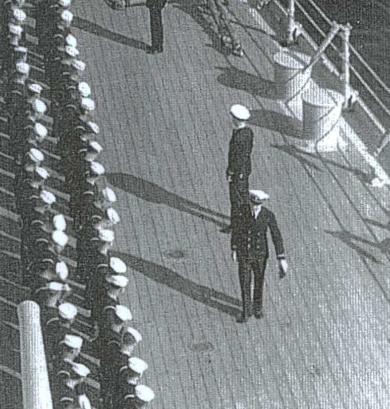

Some of the "holes" can be seen in the backgound and also in this picture:
These appear to be too large for awning supports, about two plank widths or 10"-12". They may be decklights to transmit daylight to the crew spaces below

On the second picture, I believe you are correct. But these are not the holes I am refering to. This picture shows one of the holes at the bottom of the picture next to the Admiral's cane. As you can see it is about 1/3 the width of a plank.
