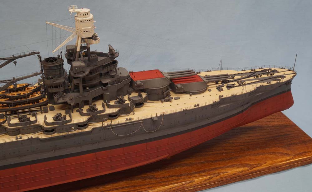

New subject, please:
Does anybody know what that little house is up on the top of Arizona's forward superstructure? It has windows and what might be an RDF directional antenna mounted on its roof.
 Post subject: Re: At 'Em Arizona Fans!
PostPosted: Tue Feb 16, 2016 9:15 am
Posts: 4046
It's an air defense control station. That's why the windows are angled upward, to permit views of the sky. There's a door on the portside that some model kits miss. The door is shorter than a normal A/T door but is paneled just like one.
Have fun, Monkey around.™
PostPosted: Tue Feb 16, 2016 9:31 am
Posts: 669
Wow, that was quick!
Thanks Steve. I have built four Arizona's now. Should have asked a long time ago.
P.S.
My friend Mgunns loves his 3D parts.
PostPosted: Tue Feb 16, 2016 12:47 pm
Posts: 10569
Location: EG48
Sheet two of her Booklet of General Plans lists that as the Main Battery Director. The platform above it was for a radar that was not fitted before her loss.
PostPosted: Tue Feb 16, 2016 1:03 pm
Posts: 669
Hi Tracy,
The outline of it is shown on the drawing of the Range Finder Platform, but I don't see an arrow to it or any nomenclature.
Chuck
PostPosted: Tue Feb 16, 2016 1:38 pm
Posts: 10569
Location: EG48
My mistake, I was thinking you were talking about the fighting tops and missed Steve's reply. There's also a weathervane on the top if you're working in large scale.
PostPosted: Tue Feb 16, 2016 2:07 pm
Posts: 669
Repulse had a device like this on her RDF office. Plus an anemometer. That's why I always thought this structure could be related to RDF's. But the air defense thing makes sense, too, especially because of the windows. (Repulse's RDF office had no windows that I can recall, and it may be pure coincidence that those two devices were mounted atop the office itself.)
I agree, the wind direction indicator is makeable in 1/350 scale but I don't think I would try it in anything smaller. If you are building the 1/200 Arizona kit--no worries, it's in the box.
So----are we all OK with the air defense station explanation?
Chuck
