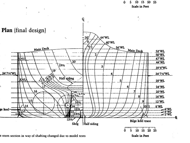

Not to forget there is a short centerline skeg at the start of the tunnel.

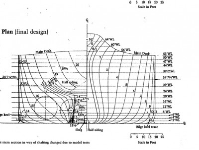

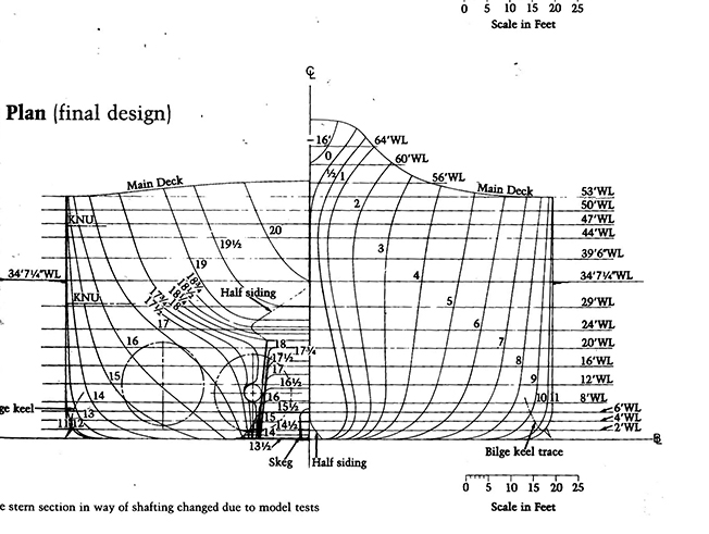

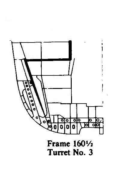

From Garzke and Dulin, note: updated version. Preliminary hull plans do not show the skeg and a few other details vary. The hull FINAL plan was revised after testing at the Davy T Model basin and includes the skeg at the inlet to the aft tunnel.

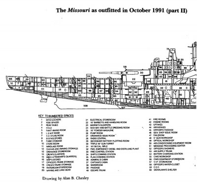

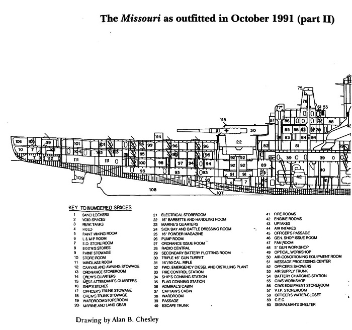

Here is an inboard profile, the item 107 is labeled as a docking keel on the other side of the page. From Stillwell, Missouri, pp 410-411

Tom: I hear you. I have a builder's drawing of the docking keel and will implement an add-on that should fit very well, but to be honest I'm a bit burned out on the bottom of the hull - I've been working on this thing for months and only recently have gotten to the point where I can turn it right-side up!
