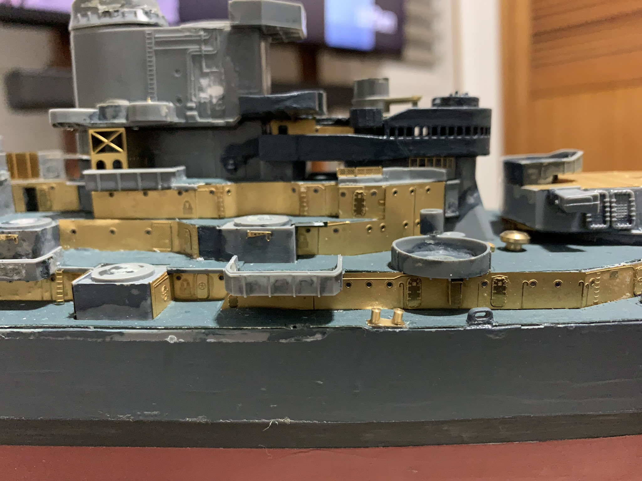

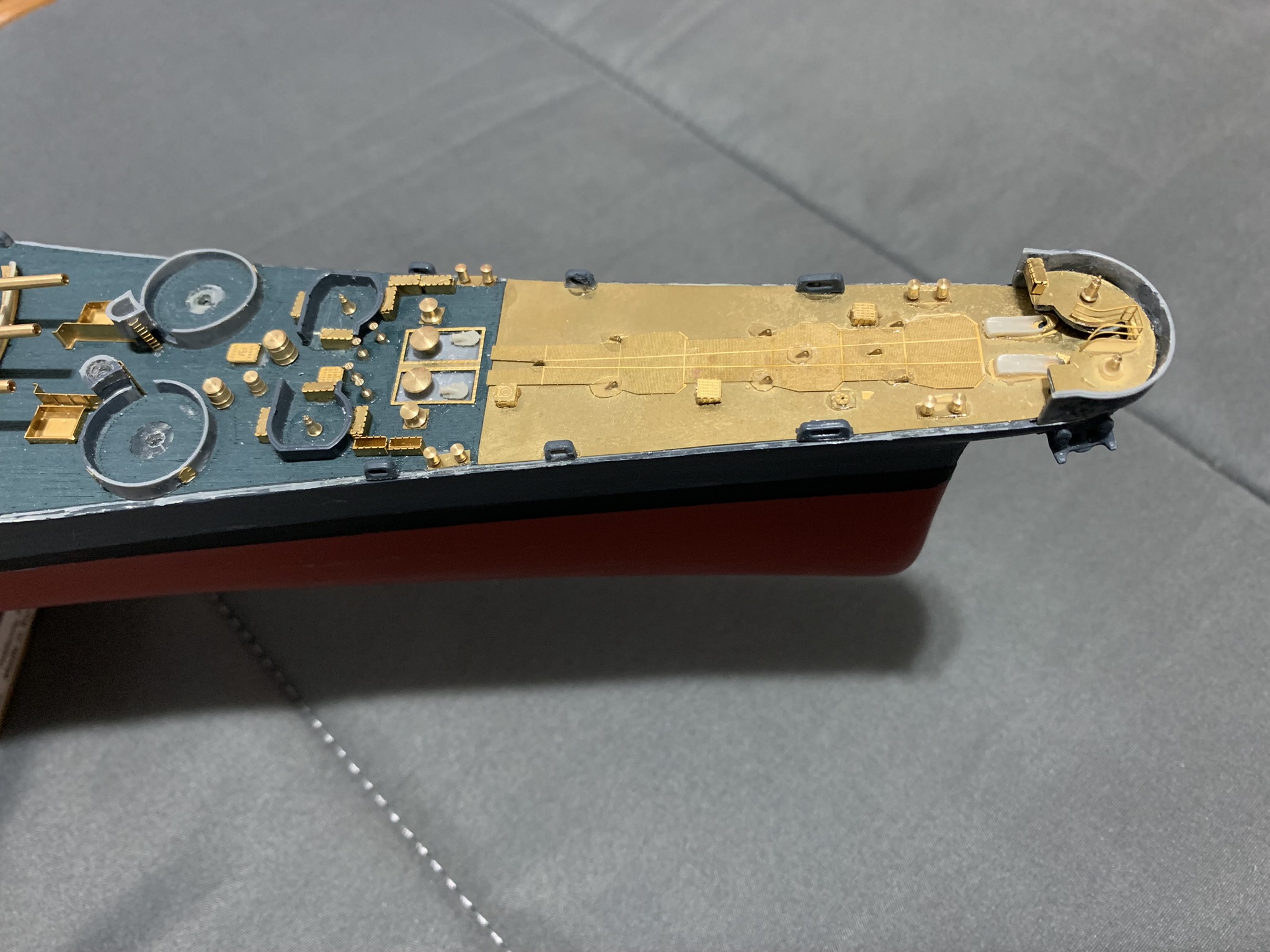

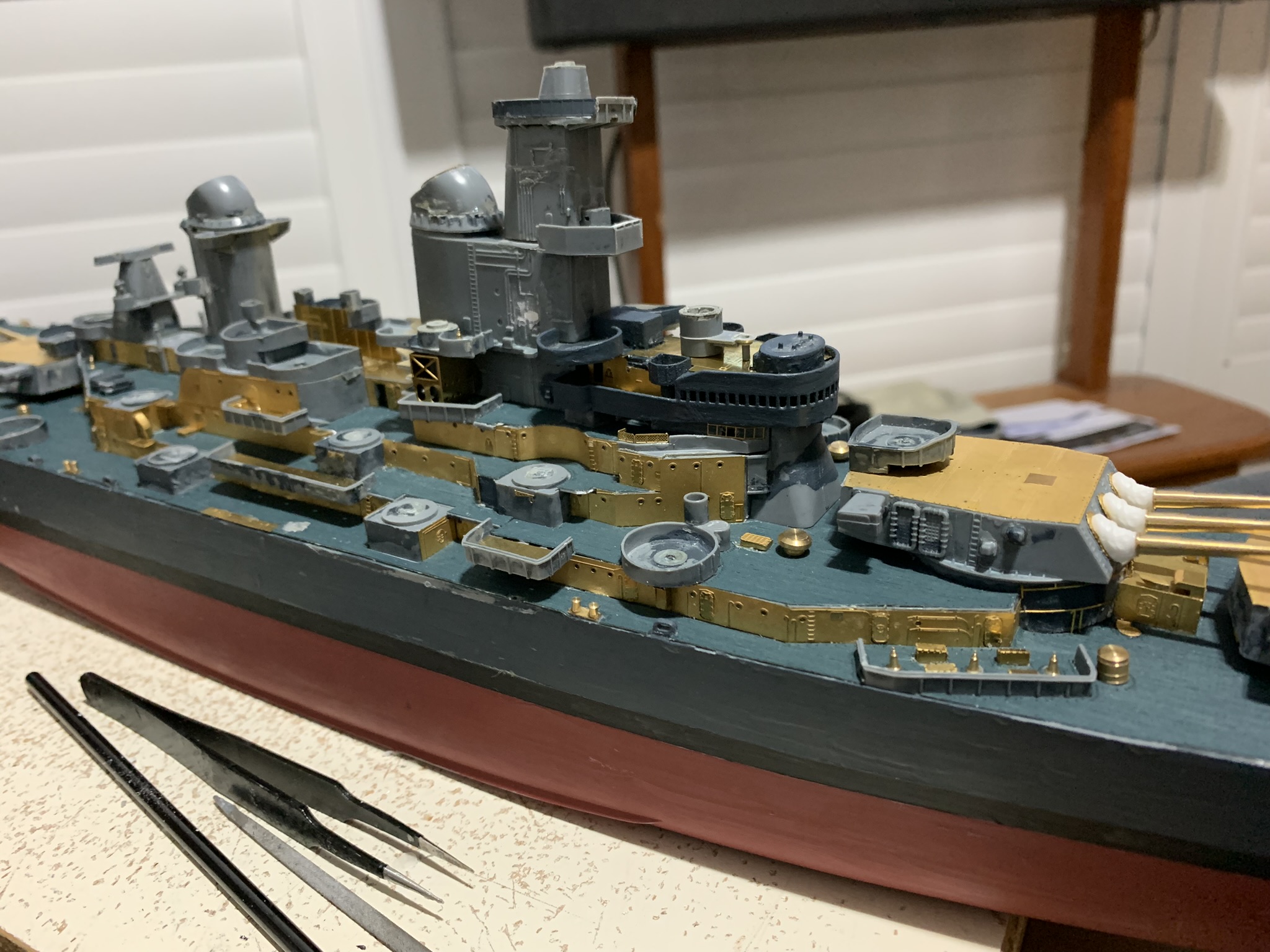

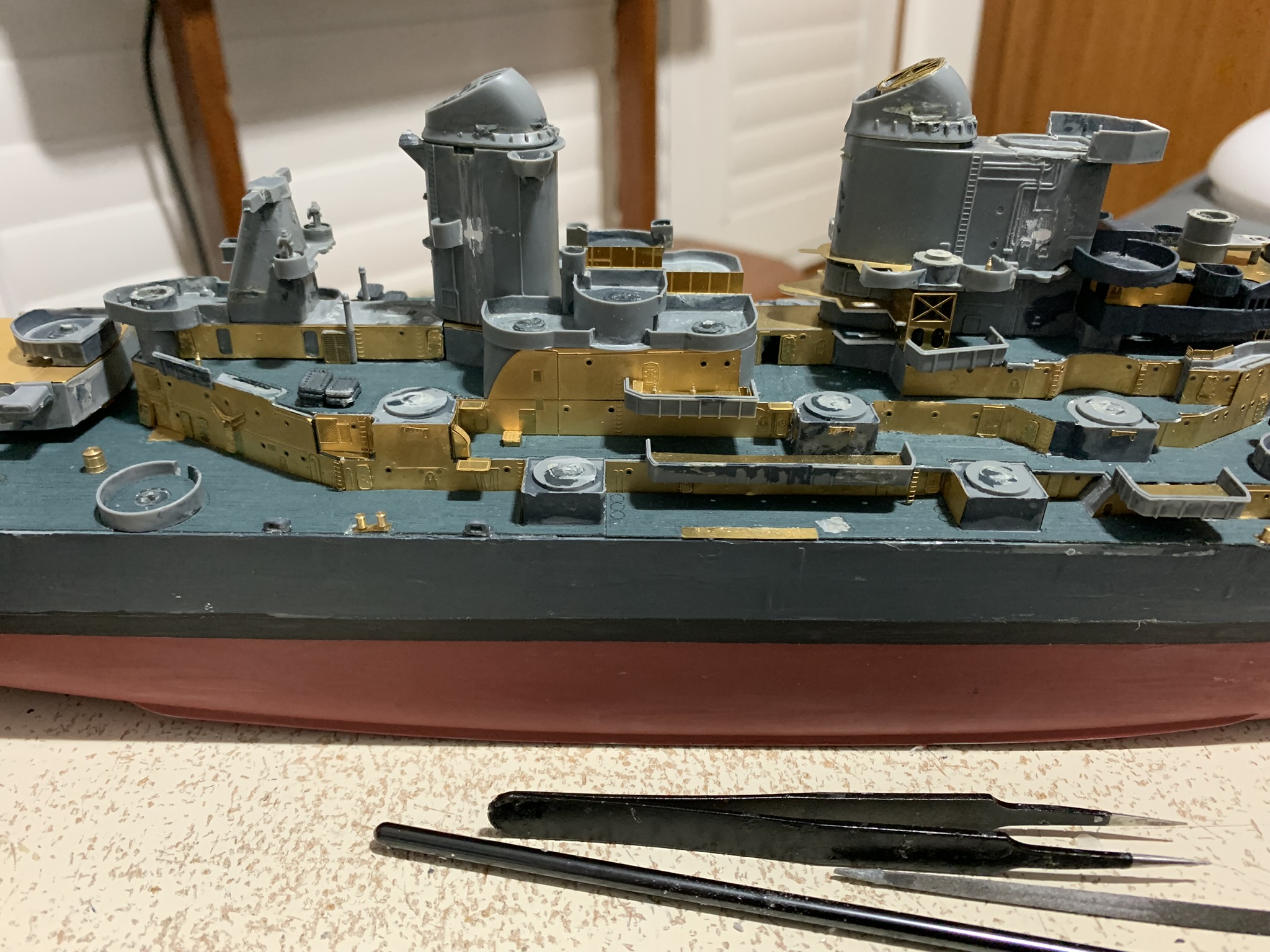

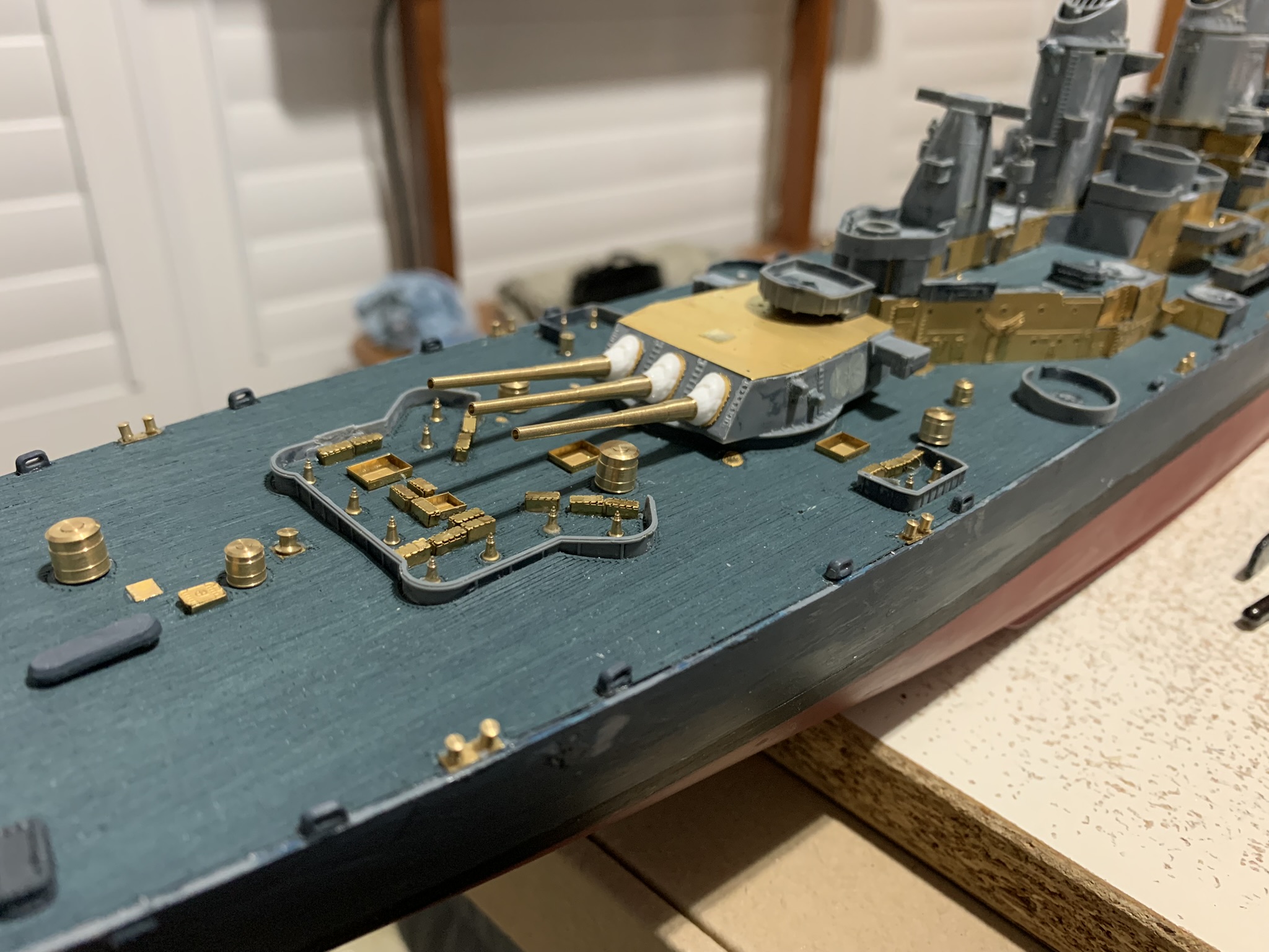

I have a work in progress.
I am using a Pontos USS Missouri kit to turn into the USS New Jersey with the Model Monkey rounded bridge.
It looks a little rough at the moment, particularly with the up close shots but I will get it better.

PostPosted: Mon Dec 11, 2023 9:30 am
Posts: 3383
Timmy C wrote:
Looks like the Plans are wrong, then. Almost like Booklets of General Plans are for illustrative purposes only and not necessarily reflective of actual practice as-built, and should not be the one and only answer to questions regarding actual ship configurations.
Photos show the Missouri had three 20mm mounts there at Brooklyn naval yard before she left the east coast for the first time, when she was off san francisco where her swoops camp scheme was painted over, during tokyo bay surrender ceremony, and when she hosted President Truman during VJ naval review back in NY.
the famous and impressive 1/48 scale model of Missouri built by Gibbs & Cox and currently in Washington navy yard also show 3 20mm mounts there.
many references still gets this wrong.
Pontos supplies two alternative versions of tread plates for both if you want to do it right and put three 3s there or do it wrong, for the missouri, and put 2 there

PostPosted: Sat Dec 30, 2023 8:17 pm
Posts: 463
Sutho wrote:
I want to bring up the WWII AA gun configurations for the USS New Jersey 1944-45 with round bridge and top mast added.
I am looking carefully at the 20mm AA guns midships and notice on the lower row there are 5 guns in a line and on the level above it there appears to be only 2 guns side by side. On Missouri there are 3 guns and 5 below.
Can anyone confirm if this is correct. I am noticing multiple differences for the New Jersey to Missouri after the ship was refitted for various occasions in the war. I am trying to model it with the round bridge and top mast.
Both Wisconsin and Missouri had the three 20mm guns crammed into a space for two. Both ships lost a 20mm gun at the 05 level so the number of guns was the same for all four ships (other than Iowa's 40mm for 20mm swap).
The explanation on the USS New Jersey channel was that it was difficult supplying ammunition to a single gun so high up and by itself.
Booklets of General plans are mall director maps.
