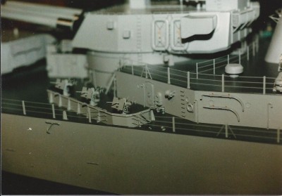

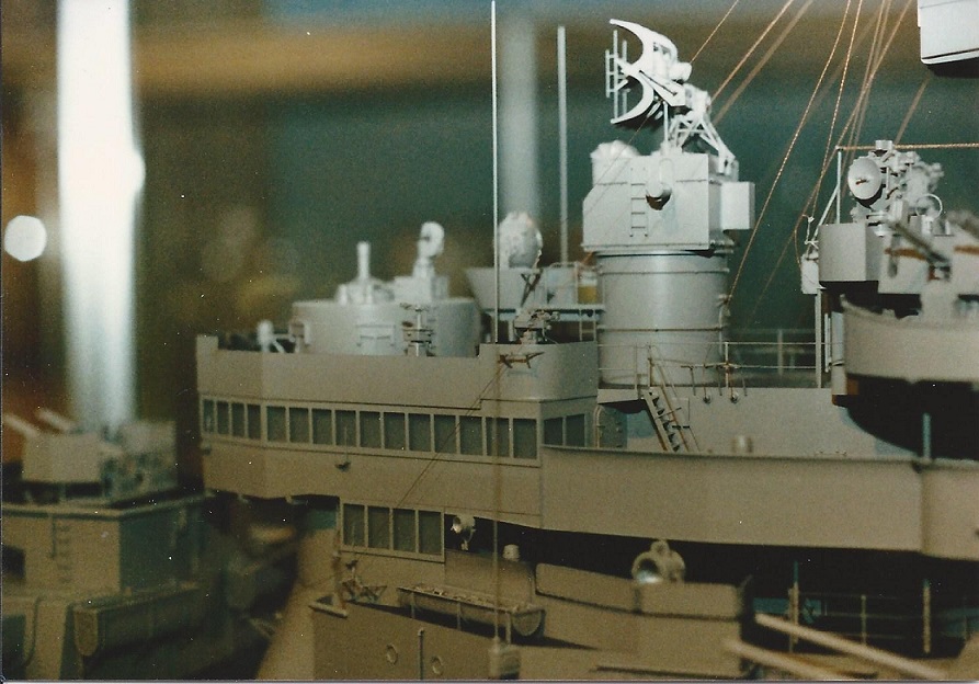

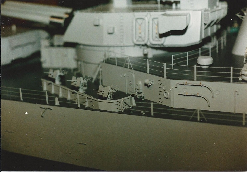

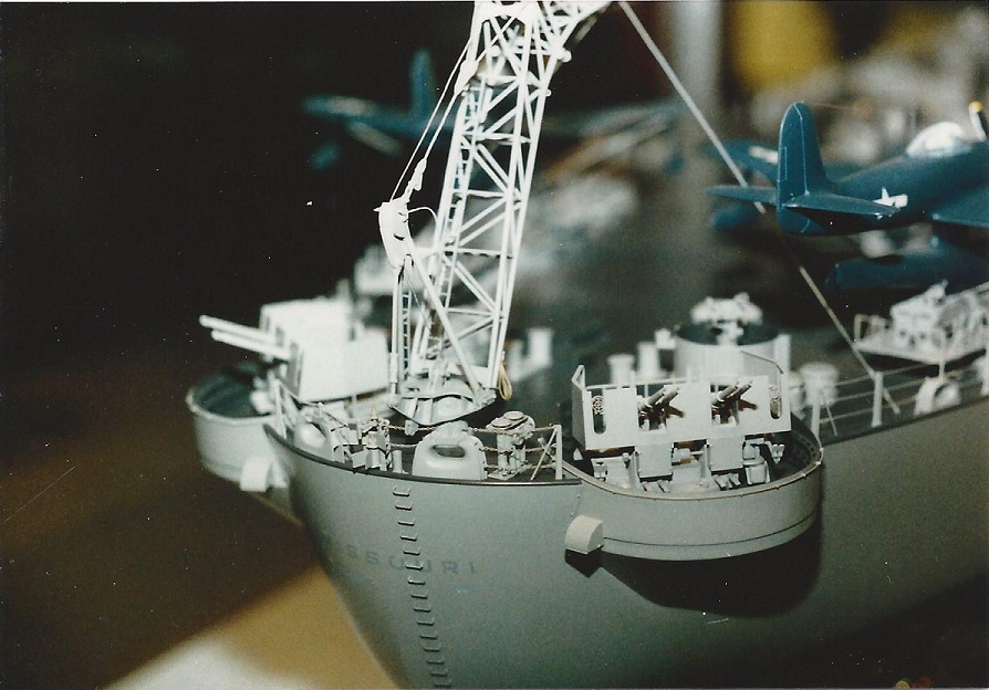

Here are some in-progress photos of my scratch-built USS Missouri, 1945
Scale: 1/192 (1/16-inch = 1 foot)
Length: 55-1/2 inches (140.97 cm).
This model is NOT be being built from the vintage Sterling kit.
viewtopic.php?f=59&t=20890&p=219506#p219506

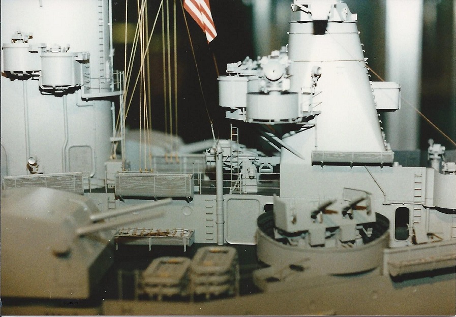

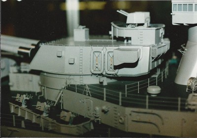

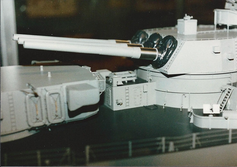

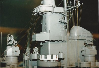

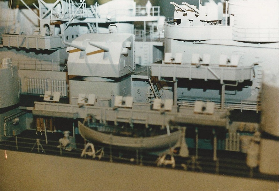

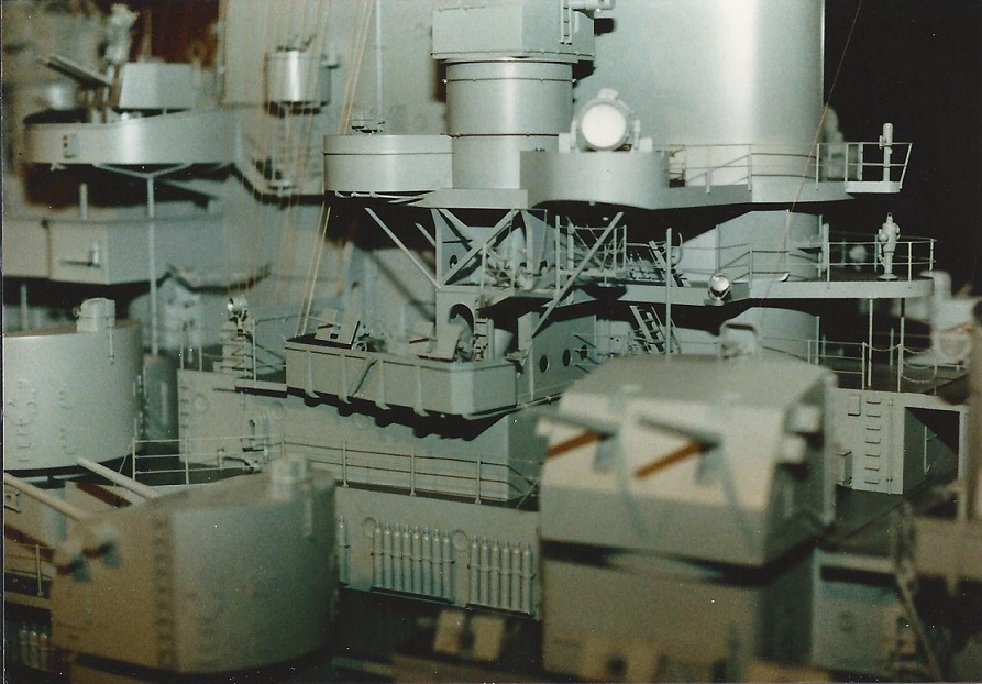

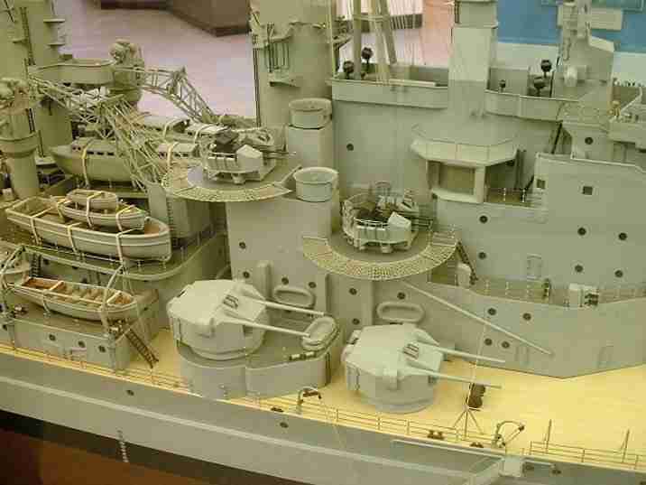

Here are some photos I took of the official USS Missouri builders model as it appeared at the Smithsonian Museum of American History in Washington DC in 1987.
The model now rests at the Navy Museum, Washington Navy Yard in Washington DC.
Scale: 1/48
Length: 19 feet (228 inches -or- 5.79 meters)
The model was built by Gibbs and Cox Company in New York and delivered to the Navy on 22 January 1951. See here for more
information about the model: http://www.dt.navy.mil/cnsm/show_01.html
The detail is superb. Her paint scheme is rather unusual in that she is Haze Gray overall with very dark gray decks and interior splinter shields.

Hi Guys,
Andy,
The optical range finding, "ears", were ill effective on turret 1 and were removed shortly after WWII.
They were too close to the water, (it was determined), and all firing were solutions came from elsewhere.
TonyB

Hi Guys,
Andy,
You can call me "quick draw", as I seem to be the first to reply to your queries.......twice!
Here we go.......
If you wish to build the same Iowa Class ship in her original configuration, and in her final configuration, you could do any of these using only Tamiya's current 1/700 offerings:
Tamiya's brand new 1/700 Iowa in her original fit, and then build the Iowa as she appeared during the 80's using, (and converting), the Tamiya Modern New Jersey kit. Explanation to be dealt with separately.
Or......build Tamiya's 1/700 WWII Missouri in her original fit, (and finish), and convert the Modern New Jersey to the Modernized Missouri.
Or.......build Tamiya's Modern New Jersey, and convert the WWII Iowa to the New Jersey.
Or........Build the future release from Tamiya of the Modernized Wisconsin,(so I have heard). and then build the WWII Wisconsin from a converted, (easiest), to the WWII Missouri kit.
I have converted the Modern New Jersey to the Modern Missouri
here is the most noticable difference....which would also need to be done to the Iowa.....
I have built the WWII version of the Missouri...BUT...I did not build the Missouri in her FIRST COLOR SCHEME, (Ms32.....1944), but in her SECOND paint scheme..(Ms22...1945)..easier to paint.
There are a few other untouched differences that I am willing to share with you...after you have decided which ships to build...IF YOU DARE TO FALL HEAD---FIRST INTO THE IOWA PIT :mad_1: :mad_1: uummmwhoooaahhahhh :mad_1:

Hi Guys,
Andy,
Now that the Tamiya 1/700 "Early" Iowa is available, you can almost build the "earliest" New Jersey out of the same box. Just re-arrange the AAA slightly, and paint her accordingtly.
Remember that New Jersey was commissioned with the exact same bridge arrangement as the Iowa, but only for a little while.
I don't have an exact time line ready, but New Jersey's bridge was enclosed, (in a rounded fashion), soon after her commissioning
and remained this way up until her first overhaul in early 1945 when she then had the bridge enclosure rebuilt to a "squared", enclosed bridge
nearly identical to the Missouri and Wisconsin's as commissioned.
There you go,
Any comments from other Iowa Class Fans is encouraged.
