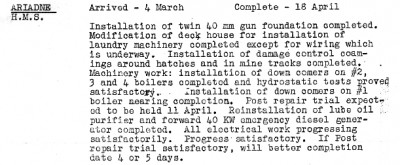

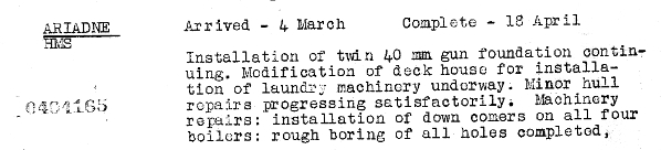

I really wonder about what camo scheme HMS ARIADNE had in the Pacific while serving with the USN. There have been debates and several undated images, many showing ARIADNE before she went to the Pacific. ARIADNE had at least one refit at Pearl Harbor when USN twin 40-mm mounts were installed. Unknown if she was repainted at that time or in Australia. Her PHNY Weekly Overhaul Reports don't mention painting, but that was pretty common in these reports ... it was considered routine and a maintenance item.

From her arrival until about August-September 1944 when ARIADNE was modified for Troop Transport OPS, she was effectively being maintained by the USN. I have no doubt that she wore "Official" RN colors prior to March 1944 and after her return to the UK. But, I wonder what scheme/colors she wore in March-August 1944 period? She could well have retained the basic pattern, but maybe with substitute USN paint????
I have had two experiences with AWM photos where they had miss-identified USN destroyers names, even though the hull numbers were clearly seen as being another ship. I have no idea of what data they have for dating the images they post, so I don't know when the photos were actually taken. It made me a little suspicious about the AWM photos and whoever wrote up the captions when they say she has HAZEMEYER Mountings for her twin 40-mm guns. But, those troubled mounts were replaced with USN Mk II 40-mm mounts at Pearl Harbor. The resolution of these images leave little ability of analyzing her configuration to date the them.
I went through this discussion about HMS ARIADNE on-line quite sometime ago (I looked it up my paper copies, holy cow they date to ... 2003!!!!) and no one came up with solid answers about her camo during this period of her service. These same AWM images were available then, but only as poor res thumbnails. I keep an eye out for photos of ARIADNE in USN 80-G photos, with no luck so far. I'm keeping my mind open to any possibility. I have a half complete model of her I would like to paint. :smallsmile:
