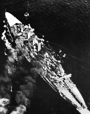

A cool project. But, the "catapult" on USS HUNTINGTON wasn't like the catapults that followed this one.
From these two images, you can see that the "catapult" was two "I-Beam" rails that were fixed in place by vertical supports. There was a gap in the supports to allow the aft turret to rotate. Shouldn't be too hard to duplicate.
This overhead view gives you a idea of the rail arrangement for stowage of aircraft and path to the "catapult".

Thanks Rick for the reference photos of catapult; makes it easier to look through my accessories stash and find likely candidates for that catapult.
