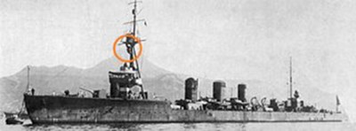

Which part do you mean? The small items in front of the mast? Or the large platform with the white canvas cover on the top of the mast (where the spar of the foremasts is fixed)?
Lacroix-Wells mentions there only the Type 13 director, which is probably behind the canvas. It the director to guide the 14 cm guns.

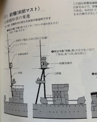

I have the answer for the question.
Based on Grand Prix cruiser volume P.167, as built, the look out station was indeed located where Dan had suggested. It was later moved down to the top of the gun director the way as it was shown in the photo I posted earlier.
I have enlarged the 'guest' photo in which he circled the 'object', and it seems(?) he either means the structure in front of the mast (red arrow middle pic) with white covers / awning around the 'windows', or the smaller object/s underneath that structure (in his original pic) on the mast itself (now 'boxed in' in green in crop from one of his other photos at bottom here.)
Guess we will have to wait to see what the guest has to say? :smallsmile:
