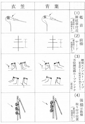

This is what I've got. More than anyone else, Mucho would know if there's more.
PostPosted: Tue Sep 29, 2015 8:14 pm
Posts: 2269
I have already taken care of the first two pair of images (the Fairlead, and the Stack).
But what is that third pair of images?
It looks like either signal lights or pulleys on a mast.
And, I can only read about three of the Kanji, which don't give me enough context to derive the rest of it.
MB

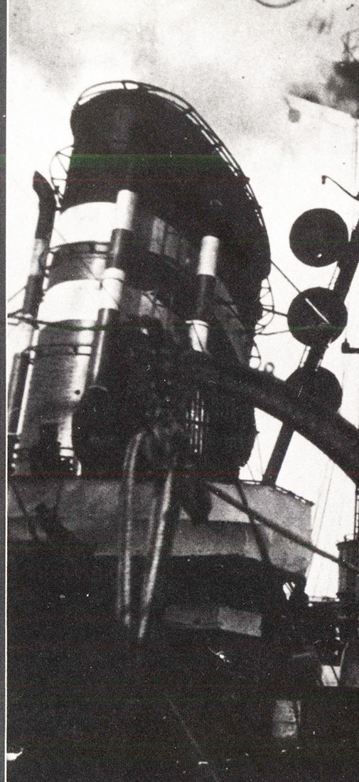

PostPosted: Wed Sep 30, 2015 10:30 am
Online
Posts: 8830
Those are range clocks, phased out during the 1937 refits.

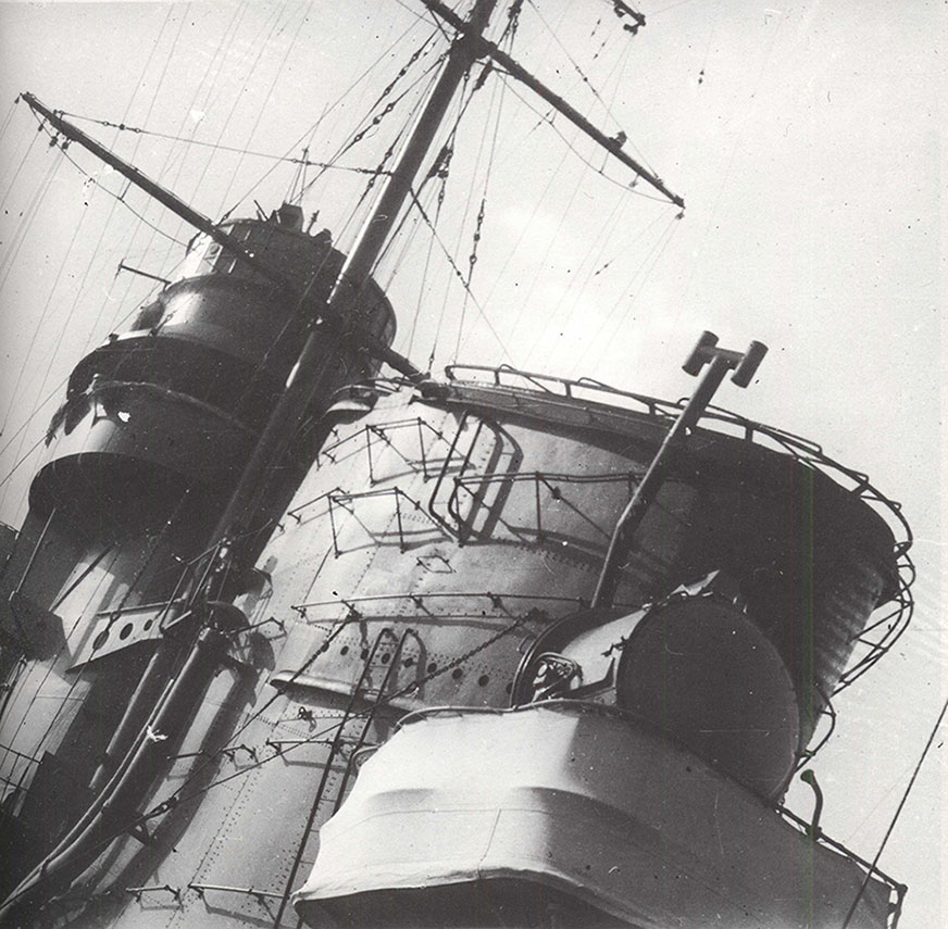

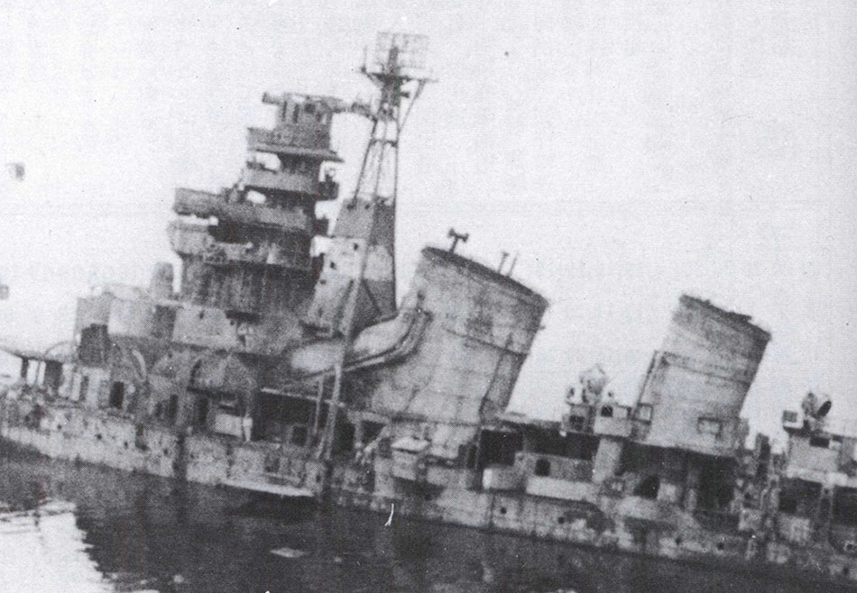

PostPosted: Thu Oct 01, 2015 3:09 pm
Online
Posts: 8830
Pretty much identical. Yes, the auxiliary pipes extend upwards from the main deck, though some may route thru some of the other surrounding superstructures. The auxiliary piping vents are varied in their appearance.

PostPosted: Thu Oct 01, 2015 5:26 pm
Posts: 2269
Excellent Photos, thank you very much.

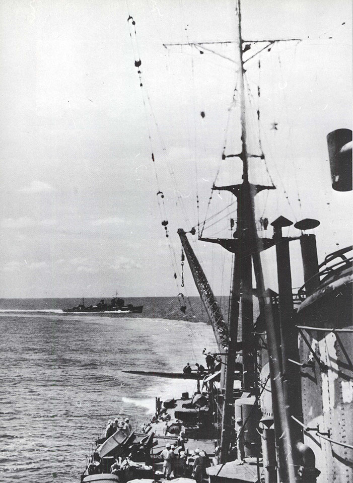

Aoba, Kinugasa, Furutaka, & Kako comprised Sentai (CruDiv) 6. In late 1941, they were assigned to First Fleet, which meant that any funnel bands would have been placed on funnel #1. In fact, there are photos from Oct. 1941 of the ships on manuevers with such markings. Aoba was wearing one band; Furutaka wore three bands. Elsewhere, Mucho had posted a photo of Kako's #1 funnel in 1941 with two bands on it. Kinugasa is really too indistinct in the available photos but she could be wearing bands on both funnels.
All of this information may be moot, though. The first Aoba funnel photo that I posted was supposedly taken in 1942, according to the English captioning key in the Nihon no Gunkan volume from which it came. No funnel band. Further, there are a few photos taken from Aoba on the eve of the Battle of Cape Esperance, including the one below, which I am re-posting. I don't think she is wearing funnel bands here, either. Nor in the post battle photo of 10/13.
Aoba looking aft at Fubuki (possibly) Oct 11, 1942, Nihon no Gunkan v #6.jpg
Aoba looking aft at Fubuki (possibly) Oct 11, 1942, Nihon no Gunkan v #6.jpg [ 173.86 KiB | Viewed 1580 times ]

Have been away,just returned from a month journey to Tokyo.
Until one comes across org/composition charts translated in English somewhere,I will have to say Dan is correct in that they are just in japanese. Indeed,such charts exist for war readiness period, i.e.1940-41.in japanese, though. For each phase of battles JACAR can provide with detailed info,too,but not all. Probably Wikipedia must have part of org charts translated by now. Not sure about it,though.
sasaki alias mucho
PostPosted: Sat Oct 03, 2015 7:41 pm
Joined: Tue Dec 10, 2013 3:33 pm
Posts: 296
Location: The Savo Island
hello, Dan. uhmm, this pic above must be of Kinugasa actually.
I´ll go in for there are some ID points in the pic which are distinguishable from her sistership Aoba... believe it or not. :smallsmile:
mucho,
PostPosted: Sat Oct 03, 2015 9:36 pm
Online
Posts: 8830
I'm all ears for those points, Mucho. :smallsmile:
Btw, the ID as Aoba came from the Nihon no Gunkan volume, not me.

PostPosted: Mon Oct 05, 2015 1:06 am
Posts: 296
Matthew and Dan,
As a matter of fact distinction points are in the above mentioned pic. Differences will be positions and shapes of;
the 2kw signal light(the rear mast)
the signal yard ( " )
the steam pipes(nr.1 funnel)
Here you go with your pin-point scrutiny. Good luck!
I think neither conventional ship books nor ijn experts have been pointing out these for more than 70 years,neither the latest Nihon no Kaigun book Dan refers to...
BR
mucho,
PostPosted: Mon Oct 05, 2015 1:36 am
Posts: 2269
Wow... He's right.
The pipes on the forward stack can only be from the Kinugasa, which has the paired exhaust piped on the rear-side of the froward funnel, as in the illustration seen earlier.
I can't mKe out the differences in the searchlight near the rear mast that is mentioned, though.
What would be the differences, so that I can reposition the one that needs to be re-positioned (I am betting I will need to re-locate the light on the Kinugasa kit, as it is basically a repeat of the Aoba, but without the AA Gun positions for the Later-War - which I am having to cover).
MB

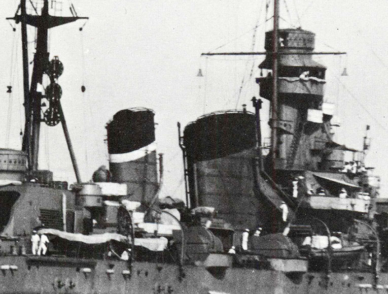

PostPosted: Mon Oct 05, 2015 7:05 am
Online
Posts: 8830
Thank you, Mucho!
He's talking about a small signal light, not a searchlight. I don't even see it in this photo. I'll try to post an example, later.
