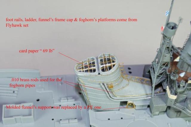

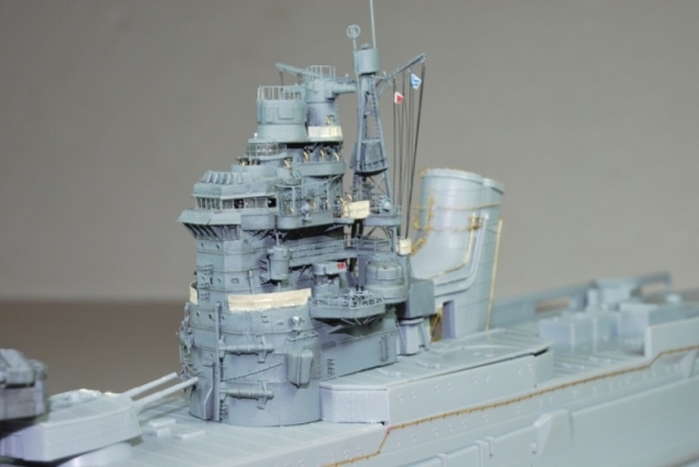

thank you guys! i have been working on the main funnel for some time now, the most i hate about funnels is having to add the footrails around it. it seems i always slack alot when i get to this step but i'll try to have it painted by the end of the week so i can move to the second one.

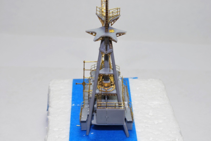

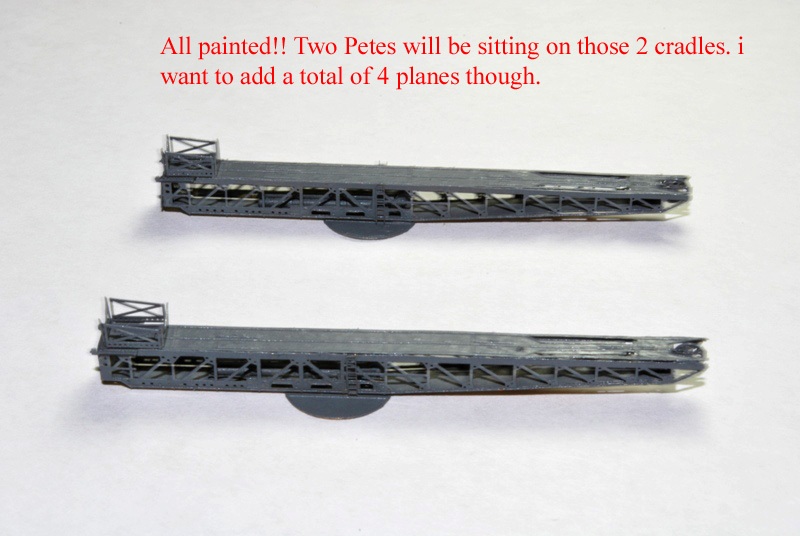

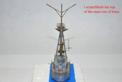

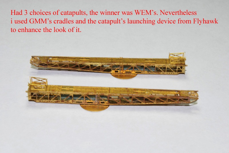

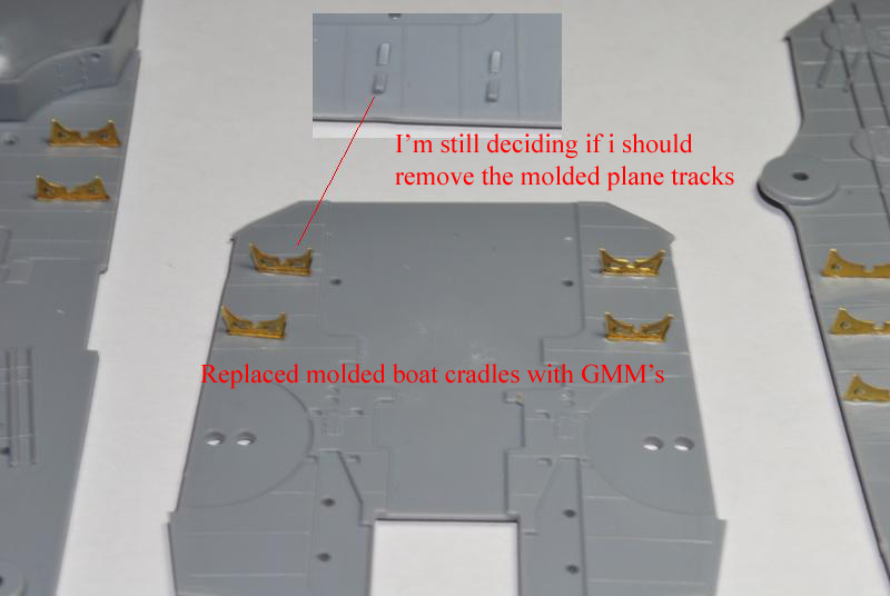

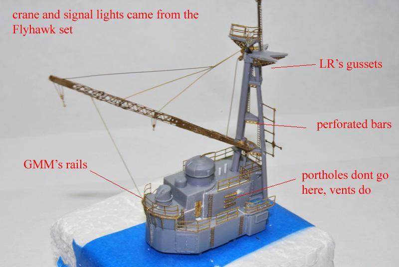

thanks Marek! it's a bit of a challenge when you have 3 different kinds of P.E sets,sometimes it takes me a few minutes to look around all them to see if i can find what i really want to finish up something hehe .
chuck wrote:
The details on the rear half of the ship is very sparse, Jose. I am very disappointed. :big_grin: :big_grin:
getting there chuck getting there :big_grin:

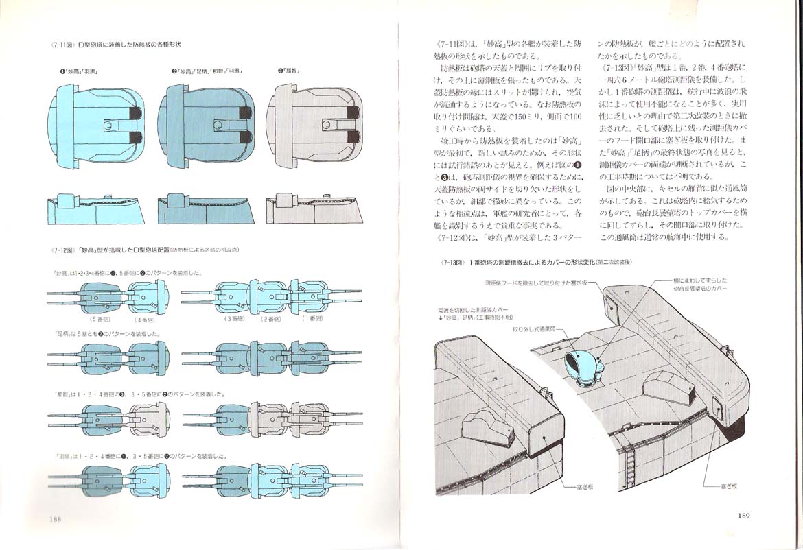

Dan do you know if the heat shields on IJN Myoko class cruisers where different from each ship ? From the kits of Fujimi and Hasegawa's each one had heat shiled minus IJN Ashigara, and IJN Myoko had on number 1#, 2# 3# and 4# turrets while IJN Nachi and IJN Haguro had on number 1#, 2# and 4# and IJN Nachi had also a sligtly different kind/shape of heat shield. At least Fujimi offers seperate turrets for IJN Nachi.
PostPosted: Thu Mar 03, 2011 12:24 pm
Posts: 8814
Good for you, Atma, that is an EXCELLENT question. The Myoko class carried the Type D turret and yes, there were variations in the heat shielding configuration between mounts, and ships. Attached is a guide from the Gran Prix Shuppan volume on the IJN CAs. From top to bottom is Myoko, Ashigara, Nachi & Haguro. On the right, note how the #1 rangefinder was cut down to a shell.

The more I learn aboout Japanese ships, the more I think I will never learn!
I was happy as a kid building a takao kit (in the 1970's) thought it was very nice. then when I re-entered ship modeling in the 90's I learned the turrets had a heat shield, now, in the 21st century I learn they had different turrets with different heat shields on the same ship!!
:heh: I'm glad it is a hobby!
(but I still dream of building that 100% accurate and perfectly made ship model)
