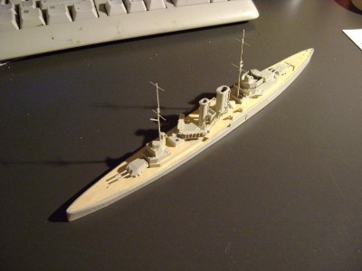

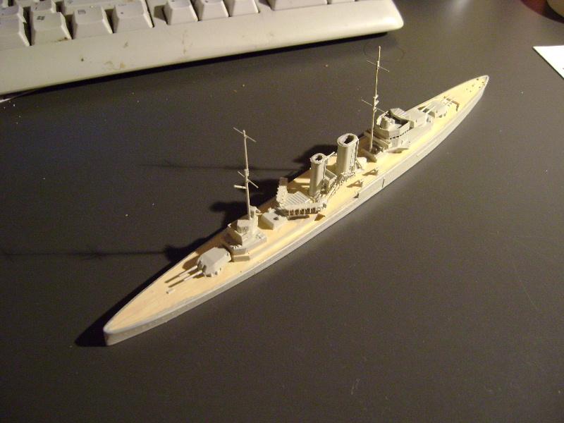

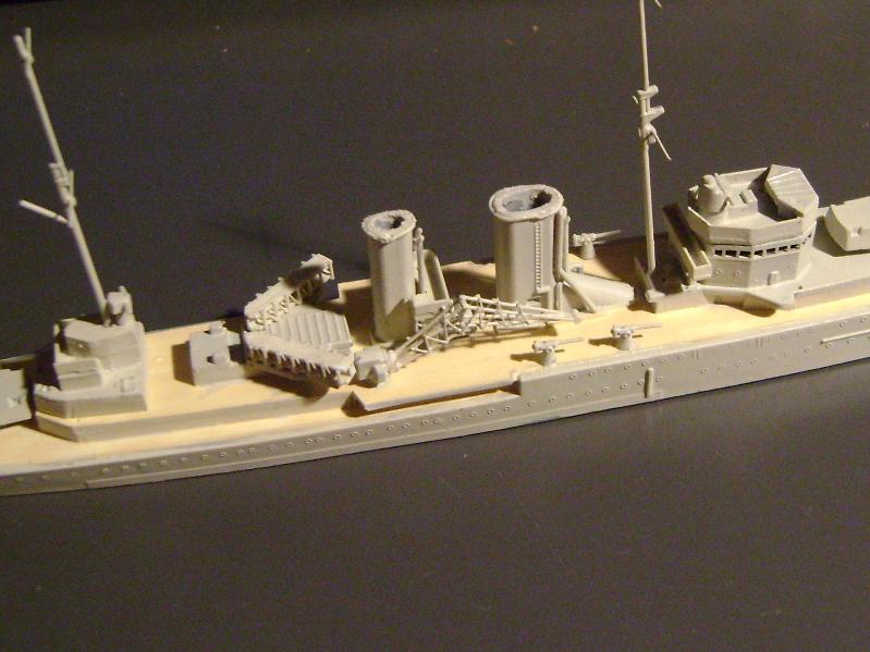

A while ago, i took out the Alanger/Matchbox repop Exeter for a spin. I decided to use her as a experimental hulk for plastic surgery. No attempt at historical/technical correctness was attempted: this was seat-of-the-pants plastic modelling at its finest.
The deck: a new scribed deck was installed. You can't see the scribing in the pictures, but it's there. The two barbettes were sliced off with a new knife and transplanted without any ado.
The angled walls: where possible, angled walls were removed and replaced with drop-dead vertical styrene.
The catapults: the kit's cats were removed and replaces with a bizarre something made to look like something resembling the real catapults. The lattice effect was created by using hairs from a dishwashing brush for thick (vertical), and hairs from a toothbrush for thin strips (the angled). This is cheaper, has a more consistent shape and is easier to manufacture then stretched sprue. It responds less to solvents, however, so use CA glue.
The crane: the same method as above was used to create something with an almost-PE-like effect.

Hey, I really like your model! You've done some great mods. Exeter really was a fine looking ship, perhaps the most balanced looking of the British cruisers.
I know some people will denegrate the matchbox kit for being a bit crude but I like the look of it. I especially like the way the flare in the stern sections has been captured.
I've tried many times to buy a Matchbox original or MPC reissue on ebay and missed out as the price went over 40 US dollars. I've never been able to find anywhere on the web to buy the Alanger issue from either.
I actually have a copy of the Novo reissue of the FROG 1/500 scale kit but for some reason cannot bear to attack it with a knife and glue.

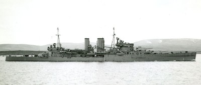

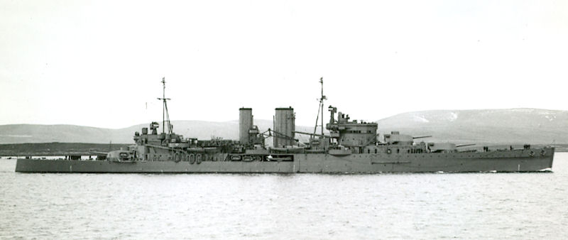

Exeter, from a post card won in a recent auction

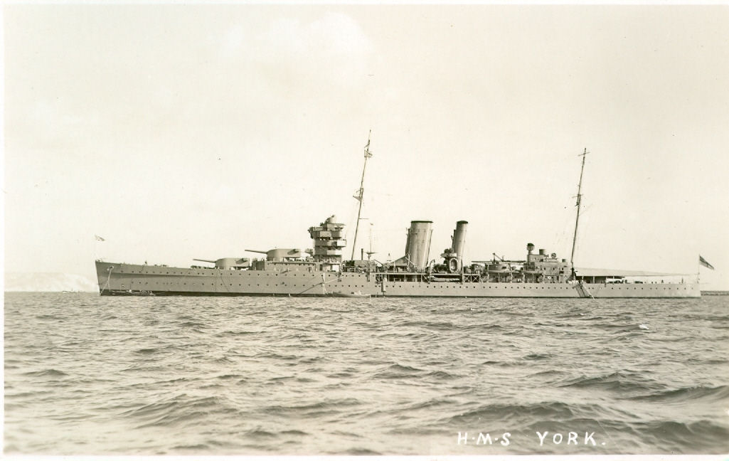

Scan of a postcard of York:
File comment: HMS York
