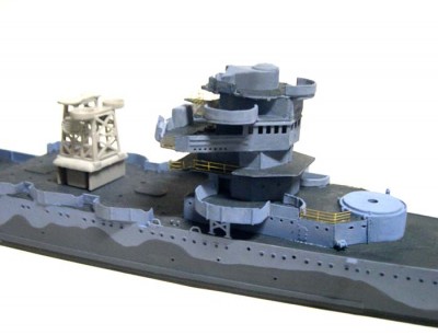

Here's a little teaser on the San Francisco kit converted to the USS Quincy.....
Almost ALL parts of the bridge were scratchbuilt. It's a real oppurtunity for me to build this rarely modeled and largely forgotten ship. I guess you can tell the differences between the Sf and Quincy
