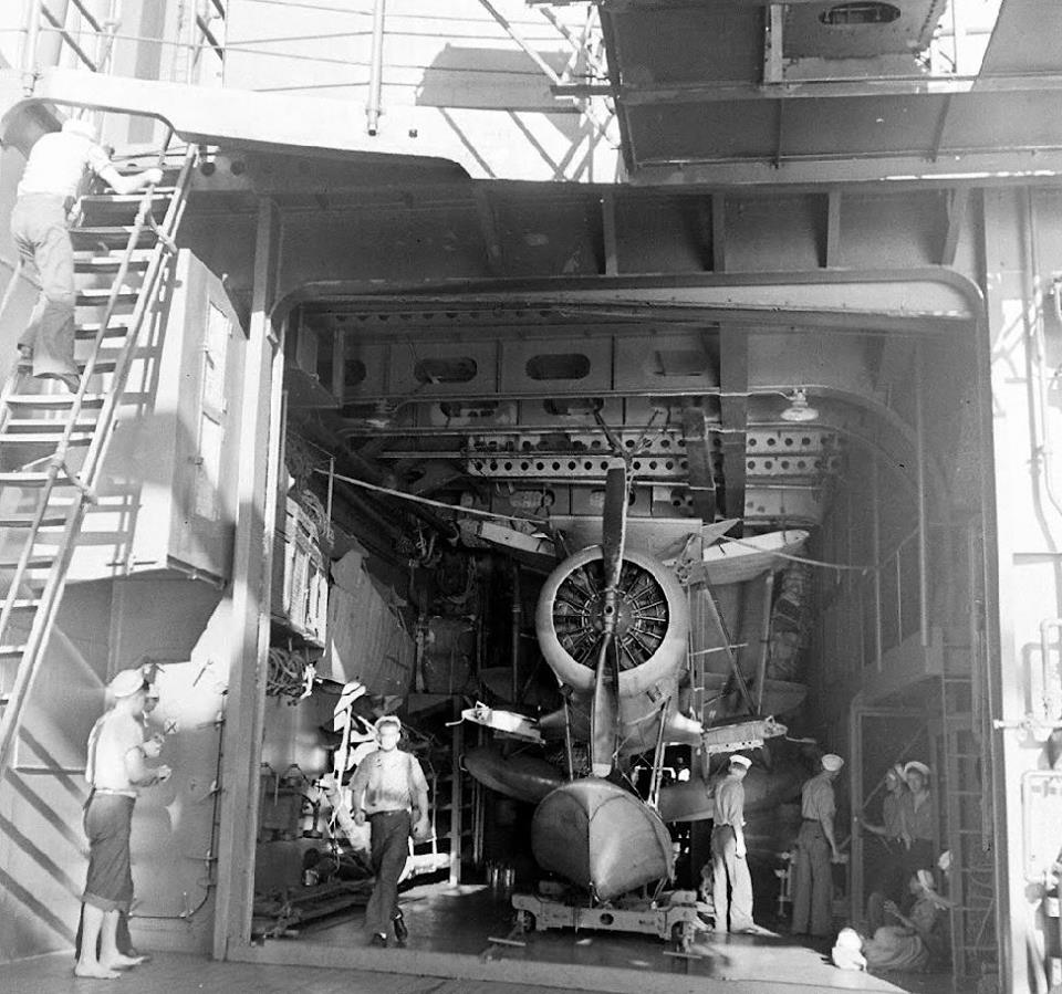

Hello guys, I am looking for a photo of a Northampton class CA that would show closed hangar door (the well deck looking aft). Any ideas please?
PostPosted: Sun Mar 03, 2019 4:36 pm
Posts: 238
Location: SE Michigan
There are some Navsource pictures of USS Chester battle damage in early 1942 that shows some shots of the hangar area but the accordion style door is open. These were later replaced with roll up style doors that were lighter.

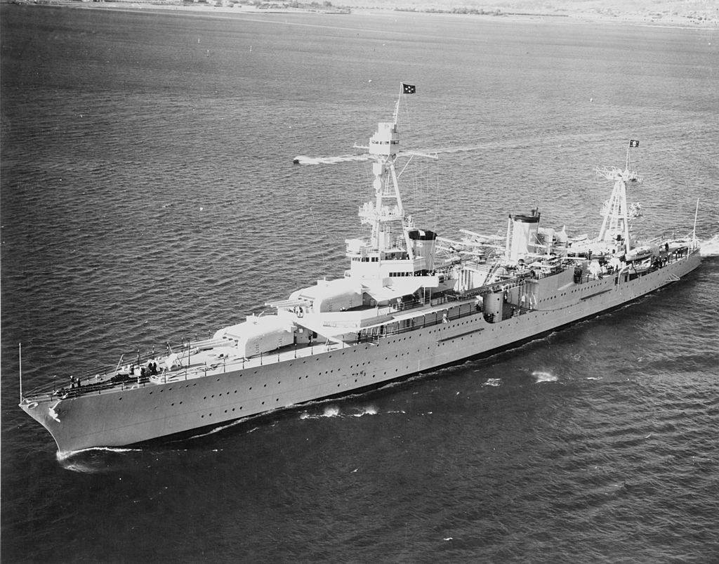

Posts: 79

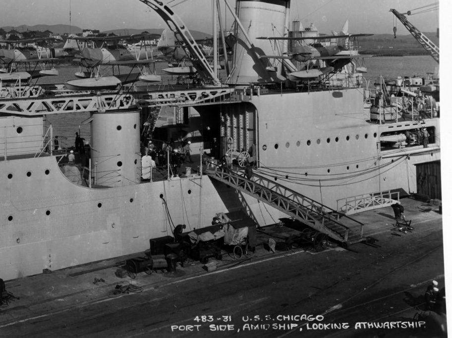

That's the most famous & widely reproduced image of CA-30. Her hangar doors were later altered to the lighter roll-up type as noted, but there are many pix of the earlier ones. Here is one that I found easily...but I will certainly have others, too.

I think I was wrong earlier. Most Northampton's had the accordion style doors the whole time (at least until loss) Chester appears to have had her hanger doors changed during the war to a swinging type door from the accordion style.
Portland had a roll up type door to start and it was changed to accordion style during her damage repair after 11-13-42. Indy got the same door change in May 1943.
San Francisco also went from roll up to accordion style doors after 11-13-42 repairs.

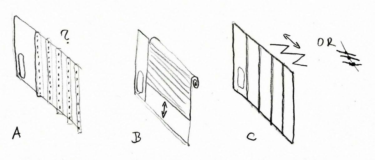

So three variants like this (pre-war to late)?
