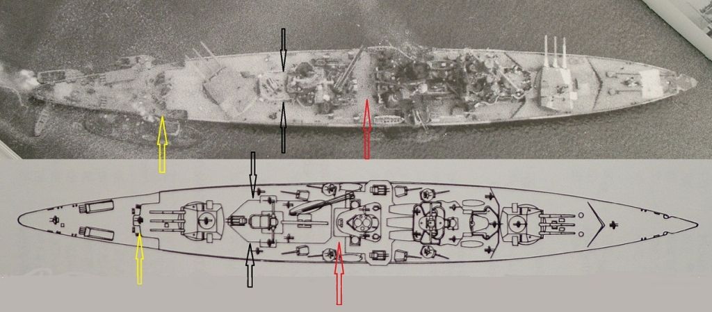

Well I too have plans about building a reconstructed Scheer, and I found the plans disappointing. On the drawings of Breyer, Koop&Schmolkeand Monografie Morskie the after deckhouse (the one behind the funnel) is too wide and long - you can check it against an overhead photograph made by RAF reconnasaince aircraft in 1942. The bridge is also inaccurate.
The best drawings I found so far are in the book of John Asmussen&Eric Leon about german naval camouflage - these match the photos and are quite detalied. No scale is given but it can be used by measuring details of known dimensions - for example waterline or main gun barrels.
PostPosted: Sun Sep 13, 2015 6:20 am
Joined: Tue Mar 05, 2013 2:31 am
Posts: 70
Some of the problems mentioned above:
1. The after superstructure is in fact narrow, not wide (black arrows), it is shorter than depicted in the drawing and there is a piece of open deck between it and the funnel base (red arrow). A minor but interesting point that the flakvierling et the end of tghe forecastle deck is not in the midline but slightly to starboard (yellow arrow)
File comment: drawing and picture from "The pocket battleships of the Deutschland class" by Gerhard Koop and Klaus-Peter Schmolke

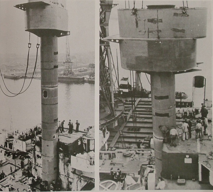

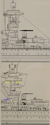

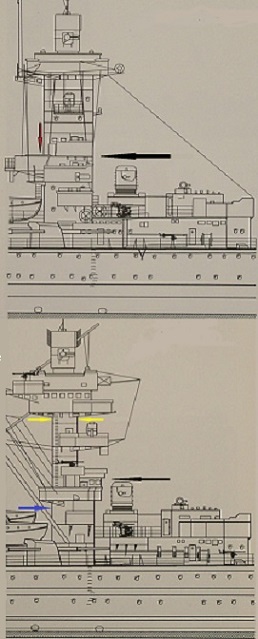

2. The bridge was cut down at the level marked by the black arrow but below the that the front face was unaltered (no overhang created) . The tubular mast is too wide in the drawing and it should be situated further aft (blue arrow) as only half of it was incorporated in the bridge structure (see pohoto below).
File comment: source: Monografie Morskie 9, Deutschland/Lützow, Admiral Graf Spee, Admiral Scheer
File comment: from "The pocket battleships of the Deutschland class" by Gerhard Koop and Klaus-Peter Schmolke

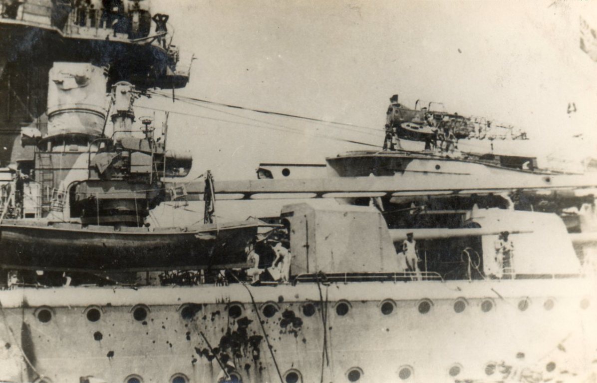

So I am building Academy's Spee and after building up the 150's, I was not happy with the amount of detail inside the enclosure. With them being open, this lack of detail is painfully obvious. Rather than add detail, I decided to close them based on some images from Kagero's 3D book that hint at doors on them. I have also read somewhere online that the Spee had metal doors fitted to the back of her 150's but have had a terrible time finding any definitive pics. Can anyone confirm that these doors existed or were they simply open/canvas covered?
Eric
PostPosted: Wed May 04, 2016 9:56 am
Posts: 352
Location: roma, italia
yes have the door
ciao peppe
File comment: in montevideo

Interestingly, from the great photo that Peppe posted it looks like the rear of the after 150mm gun is different from the one in front of it. It seems to have a cut-out and possibly no doors, or maybe in a different location?

I agree, it is extremely difficult to make out any type of door structure on the 150 to the right. The only similarity I can even find in the area is the shadows I have circled in red which might be some kind of latch to hold the doors open?
