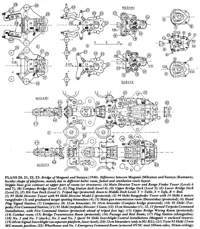

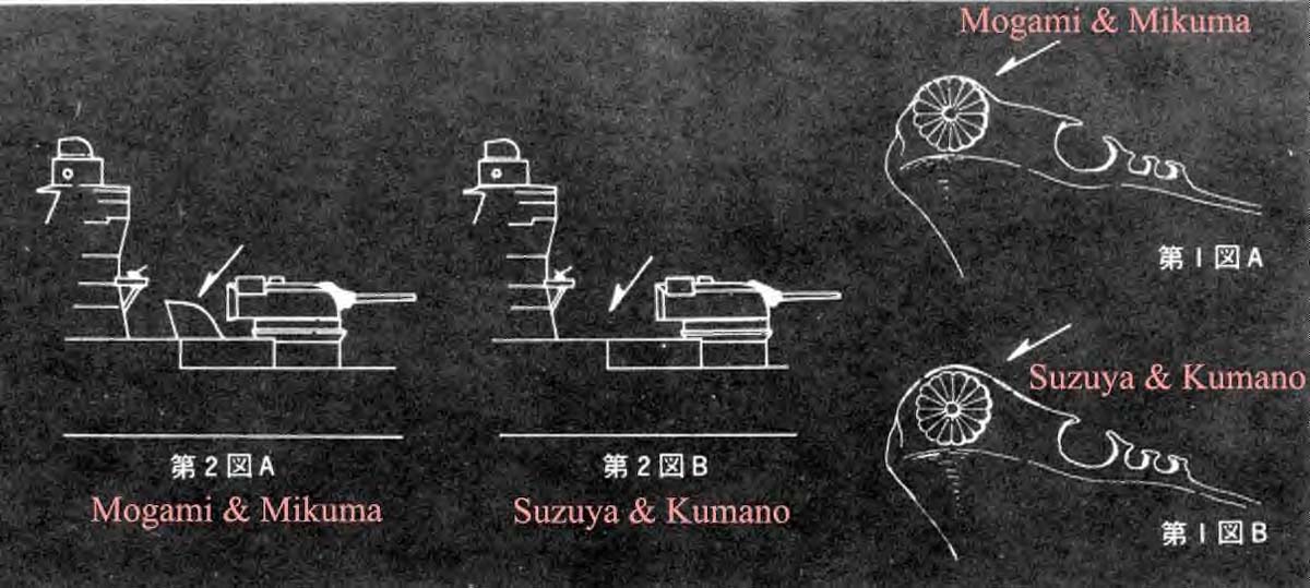

Just curious..with the release of the 8" cruiser version of 1/350 "Mogami", what differences would I need to make an 8" gunned version of Suzuya or Kumano from this same era? Were there any? I'd like to make one of these two from that kit as I already have the "Mogami" as an aircraft cruiser and the "Mikuma" in light cruiser rig..
Regards!
PostPosted: Tue Aug 31, 2010 10:46 am
Online
Posts: 8814
Well, there are some differences in the hull cross section, and venting around the bridge. There are some small differences in the lower bridge as well.
The HA deck in Mogami/Mikuma (that's the first deck above the main deck, where the TT mounts are located) juts out to either side over the hull/main deck; enough to form a knuckle of sorts at the horizontal juncture. The HA deck width in Suzuya/Kumano was reduced so as to be almost flush. So, you'd have a bit of sanding ahead of you, assuming the kit hull sides were thick enough to take it.
Attached (from a Maru Special), shows the venting, and lack thereof, between the two groups. Also, the bridge layouts from L & W
PostPosted: Thu Sep 02, 2010 9:32 am
Joined: Fri Dec 21, 2007 4:07 am
Posts: 51
Location: Tainan City, Taiwan
Wow! Thanks for that Dan! I guess I'll wait for Tamiya to make their own Suzuya and Kumano as the modifications would likely mean a new kit by them with sprue covering the changes to the bridge and other details.
