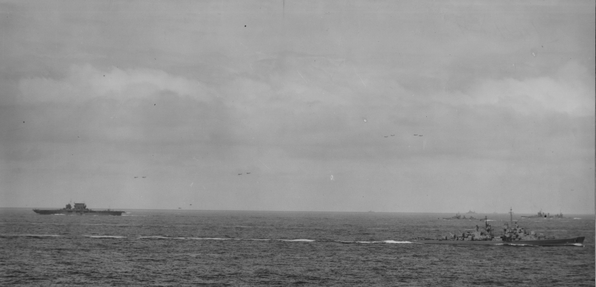

USS Atlanta with Hornet, date unknown. The card says "Battle of Midway", but I thought Atlanta was with Yorktown (this could have been after Yorky was sunk). Photo from the National Archives, via Roger Torgeson.
File comment: Atlanta and Hornet 80G-74486

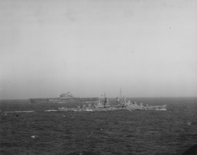

Atlanta with Saratoga during the Guadalcanal landings. Photo from the National Archives, again via Roger Torgeson.
File comment: Atlanta and Saratoga 80G-74487
