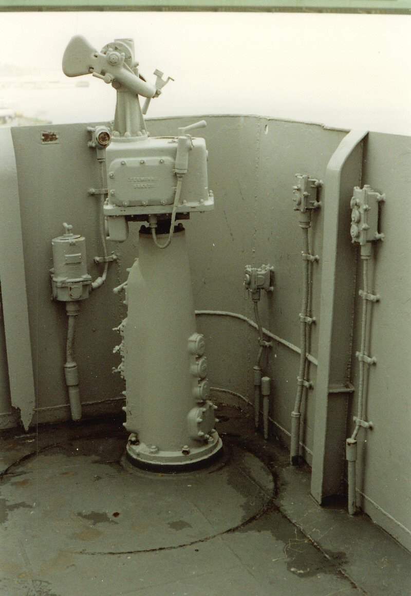

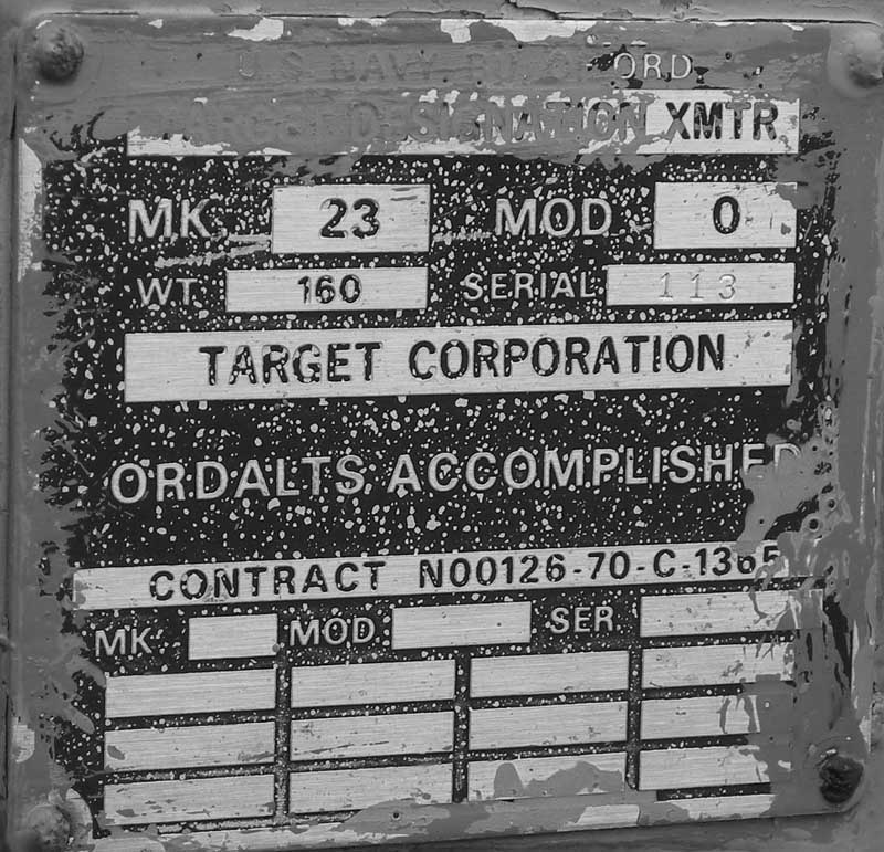

The USS Little Rock CLG-4 had Mk 23 Mod 0 TDTs on the O5 level. I have attached a drawing of the Mk 23 and a photo of the name tag off of the Little Rock's TDT (thanks to Art Tilley). These were installed in 1959 or 1960.
