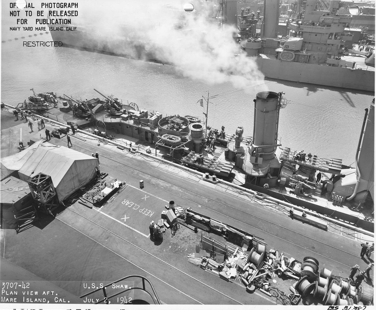

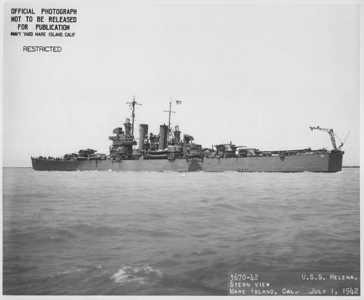

DavidP wrote:
Ian, are you certain there was 2 quad 40mm aa guns sitting side by side at that location forward of the #4 6" gun turret as awfully tight space there for those 2 mounts?
Hey David - yes, those guns are visible in the July 1942 Mare Island photos of CL-50 after refit. They're hard to make out, but please see below:
(image from Navsource, unfortunately no higher-res version of this shot is available via the NHHC)
Rick E Davis wrote:
Ian,
I'm pretty sure that wasn't the configuration for USS ST LOUIS in July 1943. More like July 1944 (when she was painted in dazzle) with additional changes like searchlight tower removed.
Hey Rick - my drawing depicts HELENA (CL-50) in July 1943 and not ST LOUIS. I have done another version of ST LOUIS in 1944 with dazzle camouflage, but have not yet updated it with a plan view. Eventually I would like to draw ST LOUIS in the 5 July 1943 configuration.
