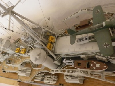

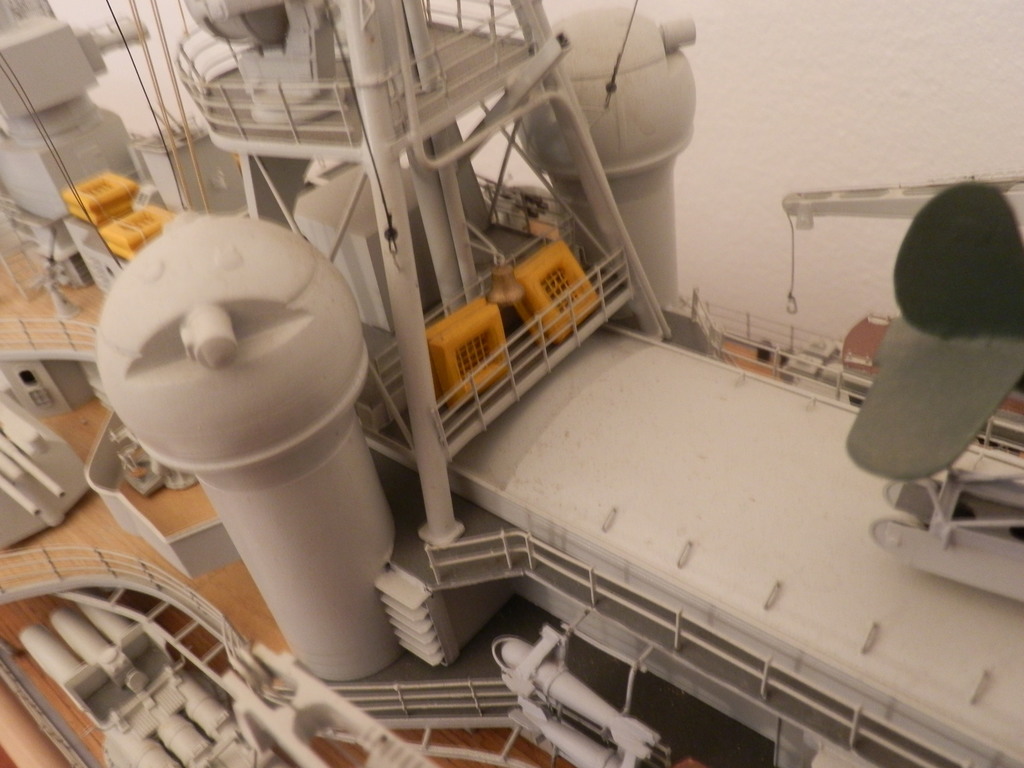

Jürgen Waldmann wants to add some detail info concerning the hangar area with two platforms with railings above the sliding hangar roof. See his fotos attached for more details.
HTH all modelers.
:wave_1:
File comment: Picture Jürgen Waldmann

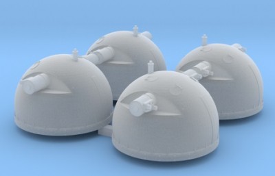

4-meter SL-8 domed rangefinders are now available in several scales. See:
viewtopic.php?f=16&t=163409
