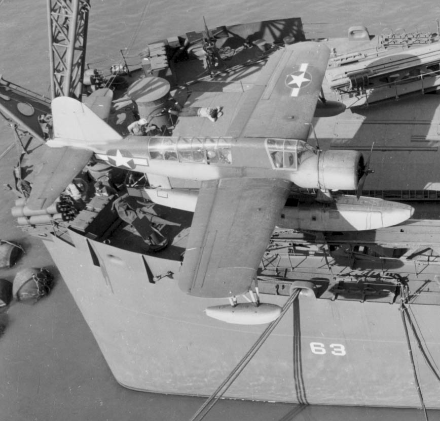

PostPosted: Wed Mar 24, 2010 2:22 pm
Posts: 1975

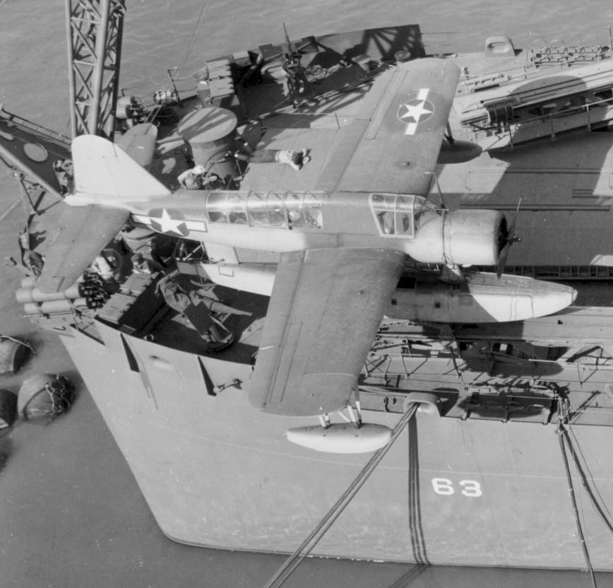

Rick E Davis wrote:
A weird thing I noticed was where they painted the "stern" hull number.
Some Brooklyn's had the same thing.
http://www.navsource.org/archives/04/043/0404302.jpg

PostPosted: Thu Mar 25, 2010 7:10 pm
Posts: 1091
I could see why the crew would want that. Cat launches are when the stern of the ship is vulnerable.

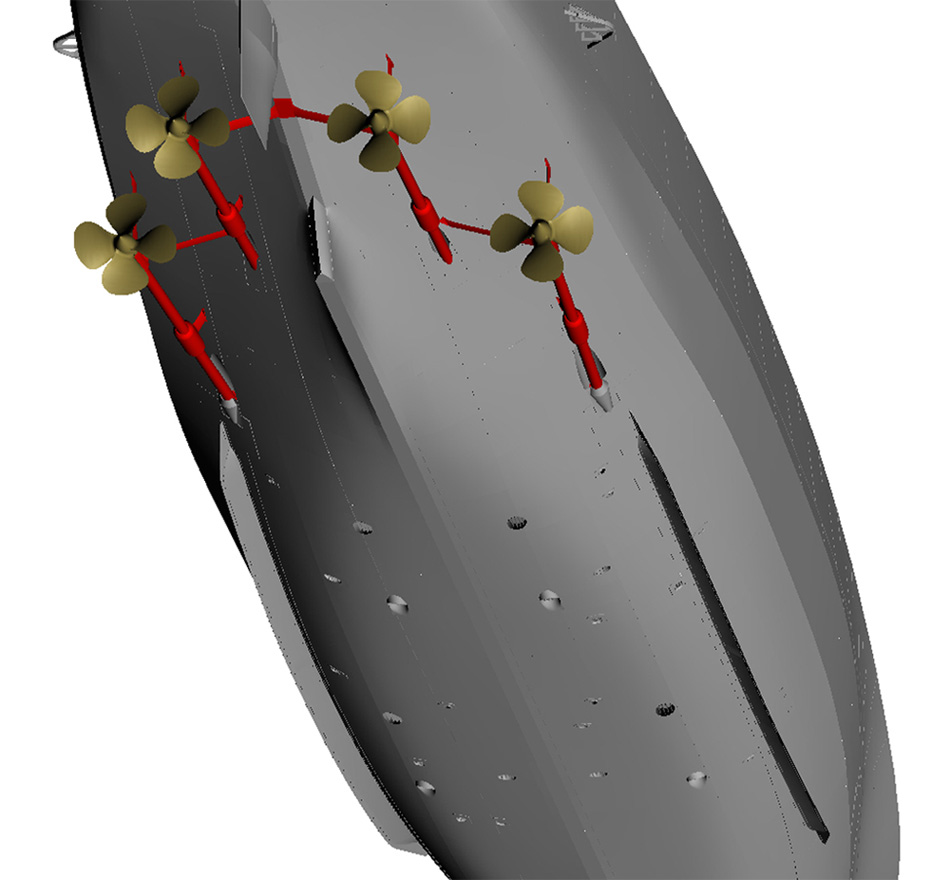

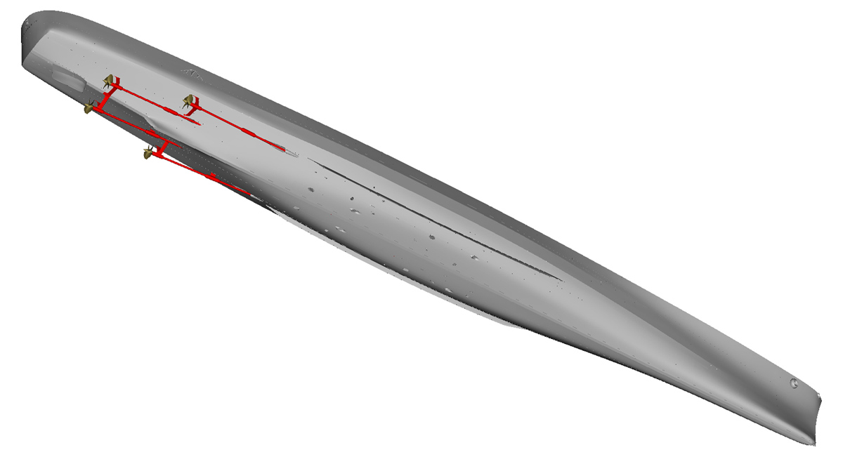

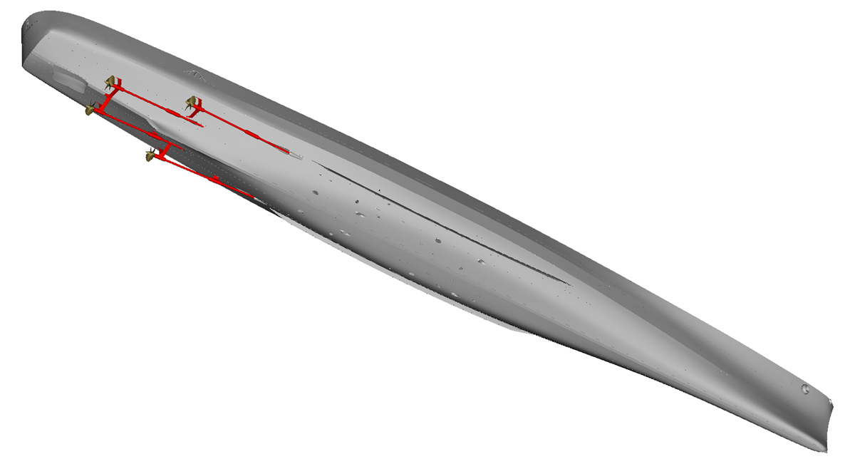

Here is a view you rarely see of the Cleveland class hull - the bottom. There is quite a bit of detail that can be modeled at the larger scales.
This CAD model is very accurate. It was built from the offsets tables, including plating sight lines used in assembling the actual ships. The model was constructed plate by plate, using actual plate thicknesses - nearly 400 plates in all, in nine strakes, and the port and starboard sides are not the same (that would be too easy)!
Note all of the sea chests (hull openings), 32 in all, some up to 27 inches diameter - that's 0.28" at 1:96 scale. The larger openings had "portable" (removable) flat bars across them to keep out larger marine animals. Mid sized intakes had perforated plates. Smaller openings and exhausts were just open holes. Also note the portable plates over the stern tube openings that faired the surface where the prop shafts exit the hull.
Not shown are the armor belts and upper hull openings (in progress).

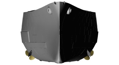

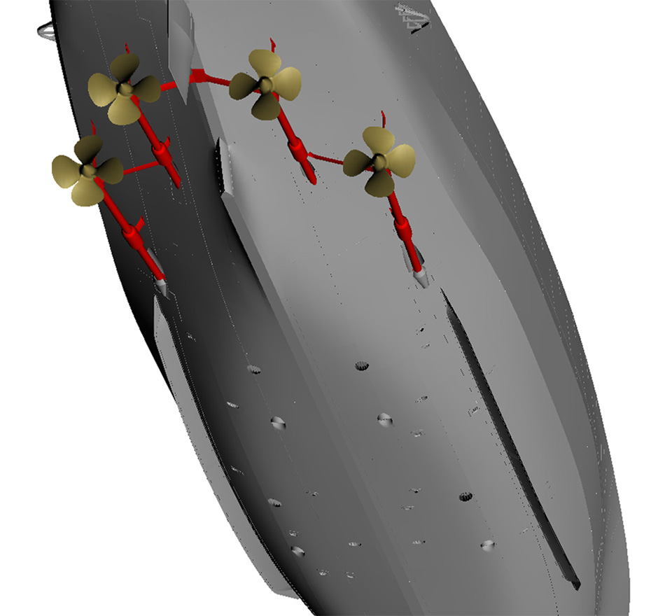

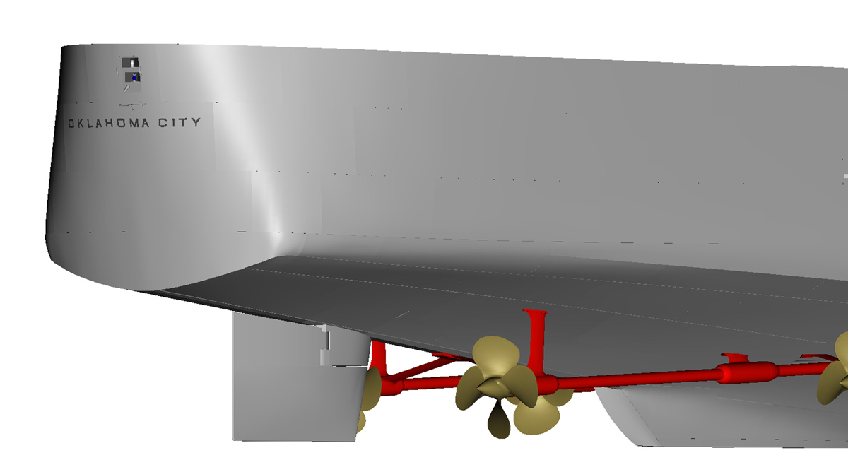

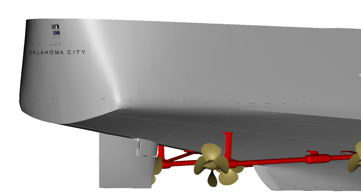

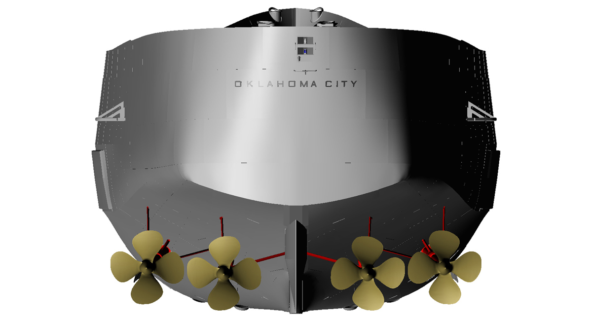

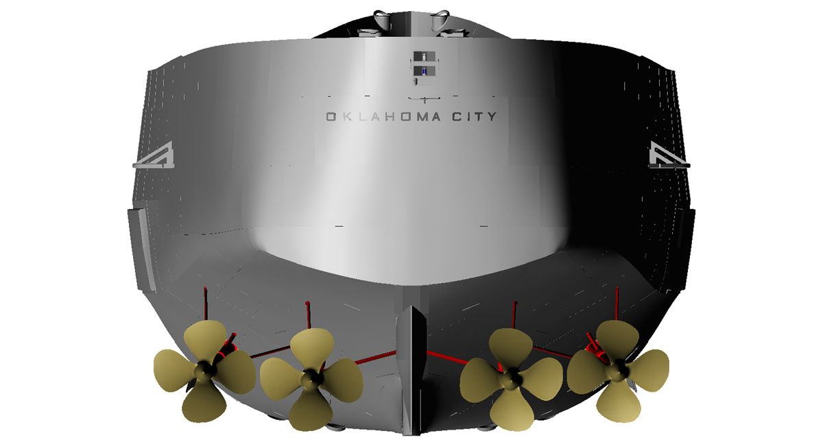

Here are some pictures showing the tumblehome. I have always been fond of ships with tumblehome - from the wooden sailing ship days. I think it gives a ship a "gothic" look, or something like that.
The bow and stern views show the way the armor belt was tilted out. A new knuckle was formed in the hull plating above the armor, and the plating sloped inward (tumblehome) up to the main deck. On the Brooklyns and Baltimores the hull sides were more or less vertical from the bottom of the armor belt to the main deck. The original Clevelands were too unstable after all the added antiaircraft armament was added. Broadening the beam at the waterline (just below the top of the armor belt) improved stability.
You can also see the radical inward slope of the hull at the stern in the stern view image. The starboard quarter image shows this even more. The hull formed a smooth curve at the main deck level, but the transom was squared off at the water line - this also increased stability and added buoyancy to support the weight of the aircraft catapults and crane.
The transition from sharp knuckle at the bottom of the transom to the smooth curve along the hull side was the hardest part to model (and probably the most inaccurate part). The blueprints show four contradicting versions, from a sharp point at the the outboard end of the transom to a broad curving transition. The hull plate edge sightlines in the Table of Offsets gave the curvature at the top of the strake at the outboard end of the stern knuckle. Fortunately I have photos of the stern while the ship was in drydock to help me interpret the drawings.
The knuckle below the armor belt gradually gives way aft to the smooth curve from the vertical sides to the bottom plating. Then the knuckle starts again at the bottom of the transom. The Baltimore hull was much easier to model because the knuckle continues unbroken all the way aft and under the stern.

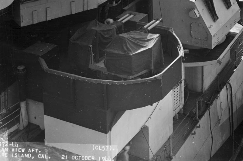

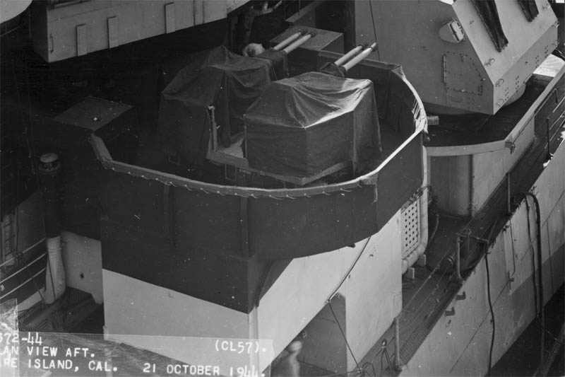

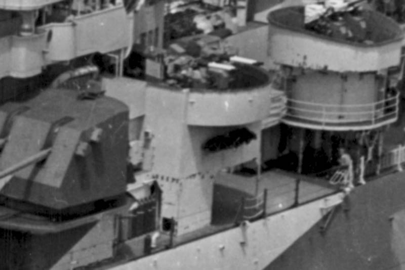

Hello Cleveland class enthusiats! Has anyone noticed the unusual construction under the forward 40MM quad mounts on CL-57 Montpelier. I noticed it early in my research, for she, instead of USS Mobile, was the original subject of my build. She appears to have been the only ship in the class with such a 'construct' ,though I have seen several photos listed as Montpeiler which in fact were not. It is very distinctive, sort of a one of a kind gun tub. She appears to have retained it all through her service career, at least WWII. I read James Fahey's war diary about his service on "Monty" but he does not mention anything about it. I was just curious if I was the only one who noticed it or if anyone knew any more about it? . . . 'the World Wonders?'
PostPosted: Fri Sep 10, 2010 12:33 pm
Posts: 1975
Cleveland went to war without any quad 40MM. She had 6 twins. Where the quad 40MM were eventually installed, she had single 20MM at the O-1 level. Columbia and Montpelier had the "box style" supports for the first quad installation added on top of the original support for the 20MM single. After those two, the more rounded support was devised, and installed on all sublequent ships of the class. A variation of the rounded support was back-fitted to Cleveland when she went in for her 1944 AA upgrade. http://www.navsource.org/archives/04/055/0405502.jpg There is a photo of Denver http://www.navsource.org/archives/04/057/0405706.jpg that is often misidentified as Montpelier, and that is probably the one you referenced earlier. Also, there are photos in the Columbia file at Navsource that are clearly either Denver (the only Cleveland variant to have the second pair of quad 40MM installed at the O-1 level rather than the O-2) http://www.navsource.org/archives/04/056/0405605.jpg or even a square-bridge Cleveland type! http://www.navsource.org/archives/04/056/0405616.jpg But if you find actual Columbia photos http://www.history.navy.mil/photos/imag ... h98064.jpg, you will see the same support as on Montpelier.
PostPosted: Fri Sep 10, 2010 6:33 pm
Posts: 1677

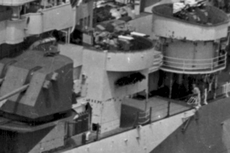

Is this what you are talking about? (I hope there are two photos attached, the Browse button shows only one although I tried to attach two)
One picture is of the Montpelier - the yard photo is clearly labeled CL57.
The other photo is of the Columbia. On the original photo that this was cut from the 56 is clearly visible on the bow.
The Denver CL-58 and later ships had the more common cylindrical support.
The 40mm gun locations are interesting. On the original Cleveland blueprints the forward dual 40mm were on the O4 level (these were originally supposed to have been quad 1.1", but they were replaced with dual 40mm) The quad 40mm guns were too heavy to be placed that high, so the Columbia was modified to carry the quads on the O2 level.
I think the Cleveland left the yards with 1.1" guns, but after shakedown these were replaced with the dual 40mm guns before heading for combat. I don't know if the 1.1" guns were ever installed on the Columbia.
