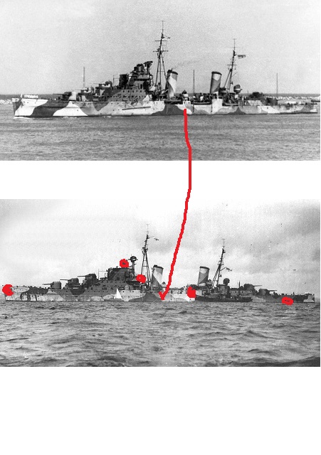

PostPosted: Tue Mar 10, 2015 3:20 am
Posts: 661
Location: UK
The obvious difference is the addition of a light tone panel amidships and the change in shape of the aft edge of the dark tone panel forward of it extending it aft immediately above the waterline.
There are then a series of other minor detail differences elsewhere doubtless resulting from repainting/touching up.
(Upper photo is taken at Alexandria and is later than the lower one which was taken at the Firth of Forth.)
