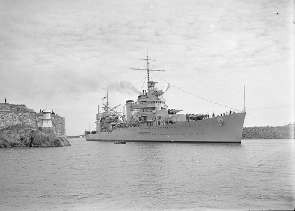

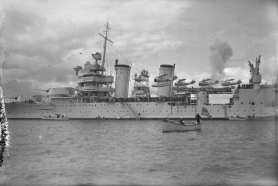

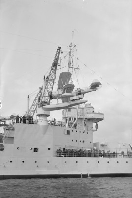

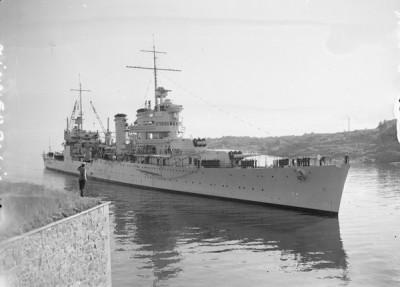

I think these pictures of CA-36 in Helsinki Finland have not been published here before. I'm planning to build a diorama of her in the narrow Kustaanmiekka strait. According to the archaive the pictures are from 1934, but this clearly is wrong. Any idea when she has been touring in the Nordics?
Please click on the pictures you find from links below to get full reso (you can download tiff)

PostPosted: Mon Nov 15, 2021 2:37 pm
Online
Posts: 12325
She conducted her shake-down cruise "in European waters during July to September 1934", according to her DANFS entry, so I don't see an issue with the 1934 date? https://www.history.navy.mil/research/h ... is-ii.html
PostPosted: Mon Nov 15, 2021 2:39 pm
Joined: Mon Jan 10, 2005 6:54 pm
Posts: 266
Location: Milwaukie, OR
1934 should be correct. Minneapolis transferred to the Pacific in April 1935.

PostPosted: Mon Nov 15, 2021 2:51 pm
Joined: Thu Oct 11, 2012 10:36 am
Posts: 50
Quote:
After shakedown in European waters from July–September 1934 and alterations in Philadelphia Navy Yard, the new heavy cruiser departed on 4 April 1935 for the Panama Canal and San Diego, arriving on 18 April to join Cruiser Division 7 (CruDiv 7), Scouting Force. She operated along the west coast, aside from a cruise to the Caribbean early in 1939, until arriving at Pearl Harbor in 1940.[4]
Thanks, I didn't realize she sailed straight to Europe after entering the service!
PostPosted: Mon Nov 15, 2021 4:31 pm
Posts: 1975
For the ship to be Minneapolis (not doubting the ID), the photos would have had to have been taken in 1934. The communications bridge below the pilot house is still open. By 1935, the deck had been raised by 1/2 level and it had been semi-enclosed. New Orleans was the only one of the original 5 to not have the comm bridge glassed in.

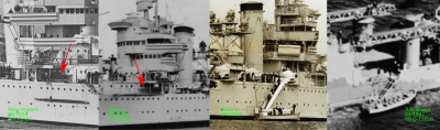

Hello everyone,
while trying to redo the piping on Astoria´s forward smokestack I spotted another minor difference between New Orleans class members. The leftmost photo below shows the pipe leading to the port whistle on Astoria „switching sides“ from starboard to port side of the funnel below the whistle platform (let´s call it the „knot“).
I checked about her sisters and noticed that this pipe went straight on Minneapolis and San Francisco. New Orleans had no whistles/pipes there until her December 1944 refit. Later there was a „knot“, too, but different from Astoria. All cruisers of the second batch (Tuscaloosa, Quincy and Vincennes) had whistles on the aft funnel without any „knot“.
My problem is I just cannot find any photo showing clearly where the pipe would originate from on Astoria´s starboard side. There are plenty of photos showing her starboard side in the thirties but the whistles were installed only shortly before WW2. I asked Dick J to kindly check his collection but he found no answer there either. If no other evidence is found I´d asume the pipe went parallel to the other pipe.
I´d apreciate if you can check your files for a photo of either Astoria or New Orleans (after 12/1944 refit) that would show the starboard side of the face of the forward funnel with at least some clarity in the area of the "knot".
My shared New Orleans class comparison table (as of 1942) was updated accordingly to include this feature across the class.
Thanks :wave_1:
